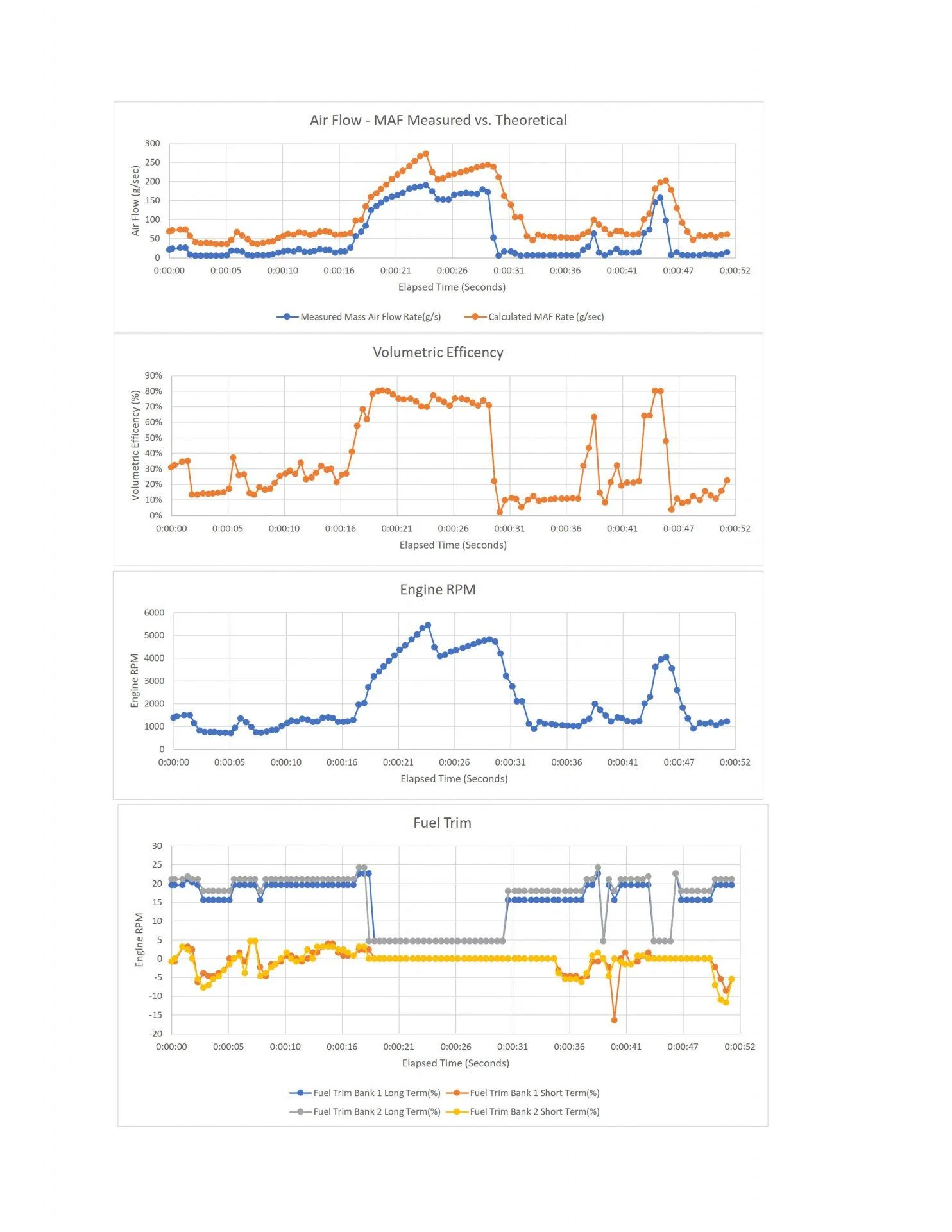

I had a separate code reader for years (bought it prior to the advent of smartphones) and would never want to go back. Using the phone-based app provides a lot more flexibility and allows for data logging of sensors and export of the data to a .csv file that you can pull into Excel and process. It's a huge benefit when trying to troubleshoot and monitor the health of an engine. See the attached volumetric efficiency testing I did on my GX when troubleshooting a MAF code and high fuel trim issue (ended up being a vacuum leak and bad MAF sensor connector). There is no way to do this with a lower-cost standalone code reader that doesn't link with the processing power of a smartphone. A standalone reader with this capability would probably be hundreds of dollars (not $32 like a Bluetooth/WiFi reader and a smartphone with Torque Pro).
