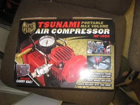

I also carry a 12 volt compressor I bought from E9999 years ago. It's a great back up, but 30 minutes for four tires.
