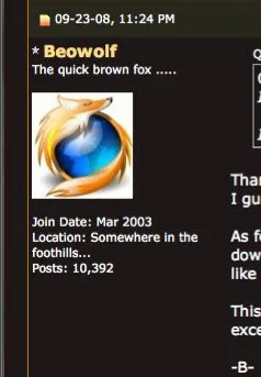

Wouldn't it be easier to call you the Bee Hunter from now on? :cheers:
For the life of me, I cannot understand how people can misspell something that is RIGHT THERE IN FRONT OF THEM when they type the message. Its not like they have to use a dictionary or something. It is on the left side of every post!
<======= See! Look over there! IT IS Beowulf
sheesh.
-B-
I think this is what they see
