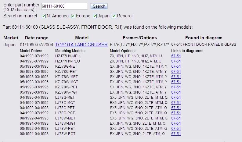

hey all, some kids smashed my drivers window at the weekend, little feckers. when i was told initially i thought it was the windscreen, so actually im thankful it was something easy to fix.
im wondering what will fit it.
its a pzj77, same body as an lj78
alls we have in Ireland are lj70, lj78, kzj70, kzj78 versions.
are the front doors the same across these models?
looking at the epc, it seems part number 68111‑60100 (tempered glass) is fitted to the following, but not the short lj70/kzj70, which kinda decreases my options
They dont fit. the short wheelbase doors are longer than the 4 door models, presumably to facilitate entering the rear of the vehicle. the glass is also longer.
