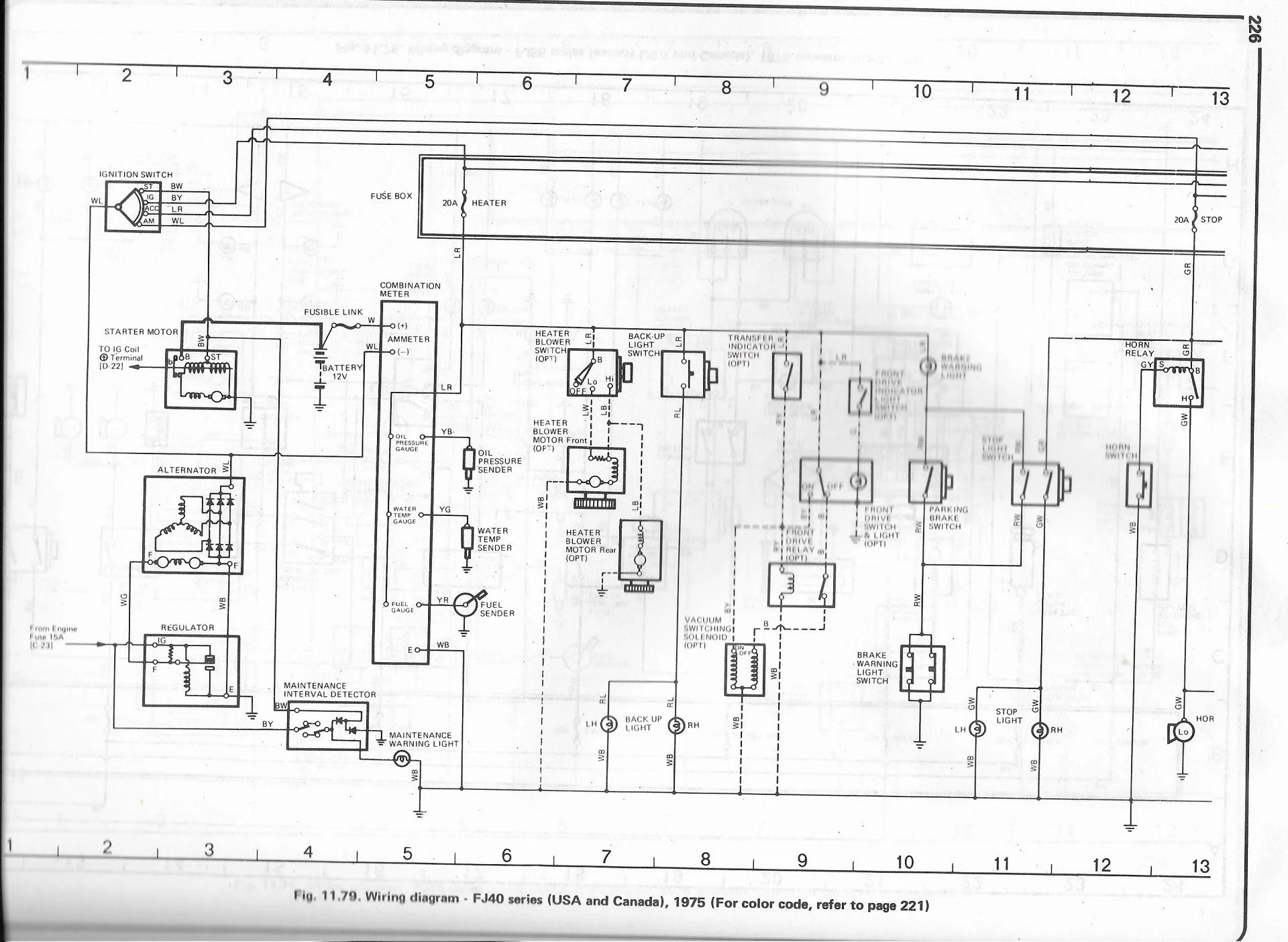

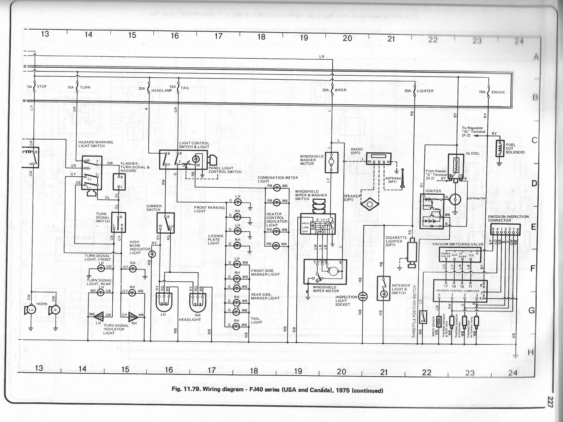

Fortunately, '75 40 is a clear factory diagram. Don't mess with the Painless harness, fix the original. I fixed my mouse nest out of a pile of potential short circuits.

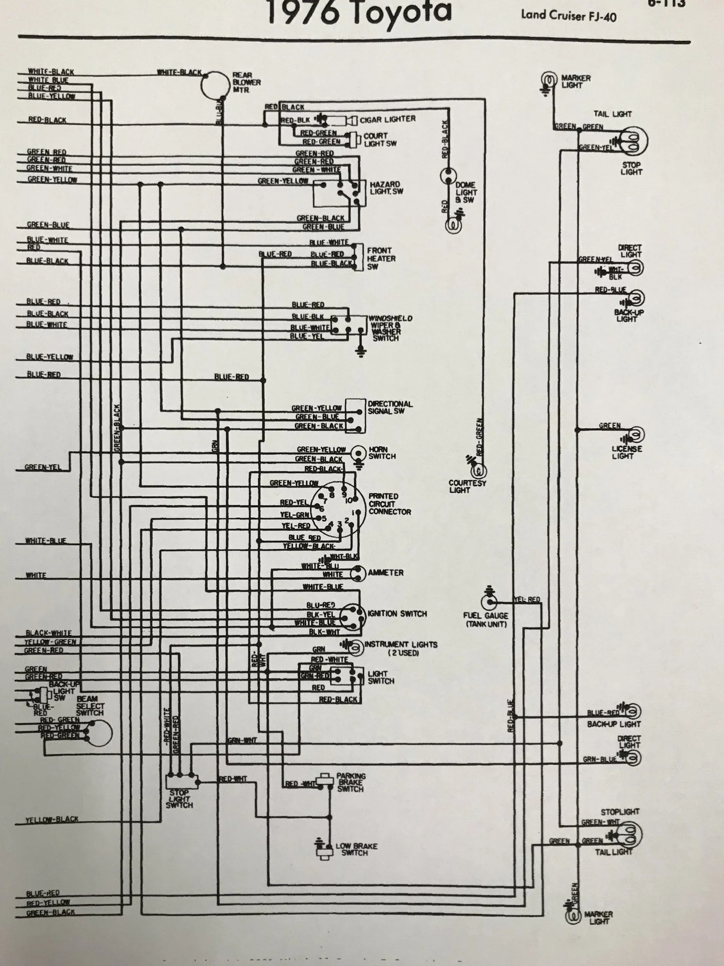

I have got the 76 wiring diagram in my shop, I will take some pics and post tomorrow.

Thanks for the reply. I went through and repaired wire and connectors, labeled most of the connectors. I do have a emissions computer but all the smog stuff was taken out by PO. I do have a enlarged wiring diagram. it also came with a pertronix electronic distributor, coil and big green monster alternator, all new stuff. That was part of the wiring question. I will get back to you on the help part appreciate your time. Thanks, Guy
