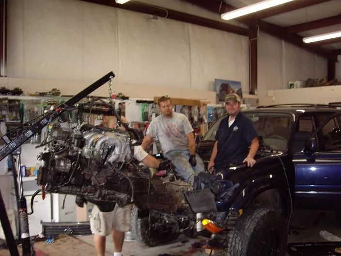

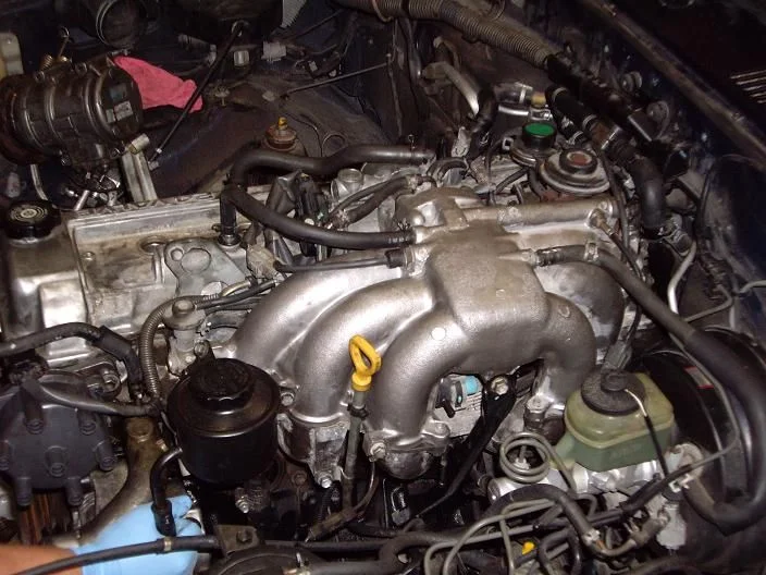

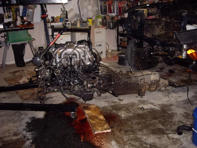

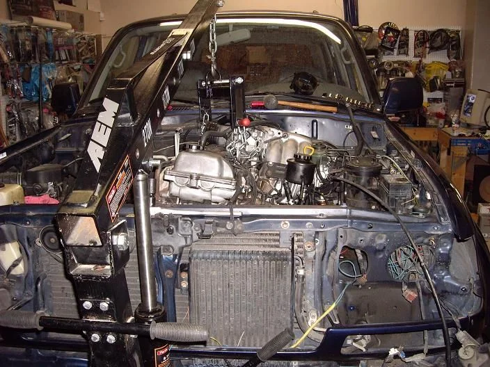

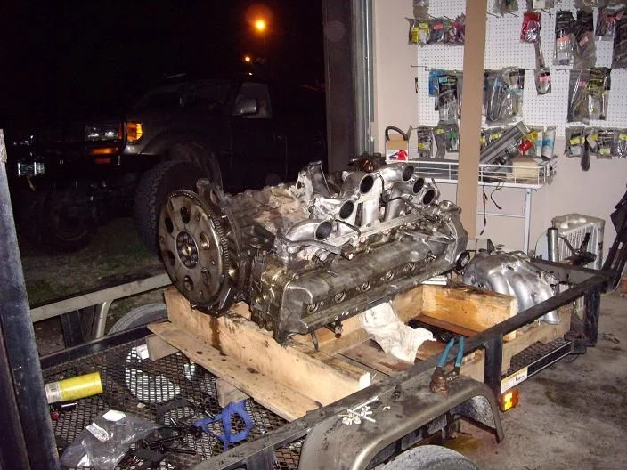

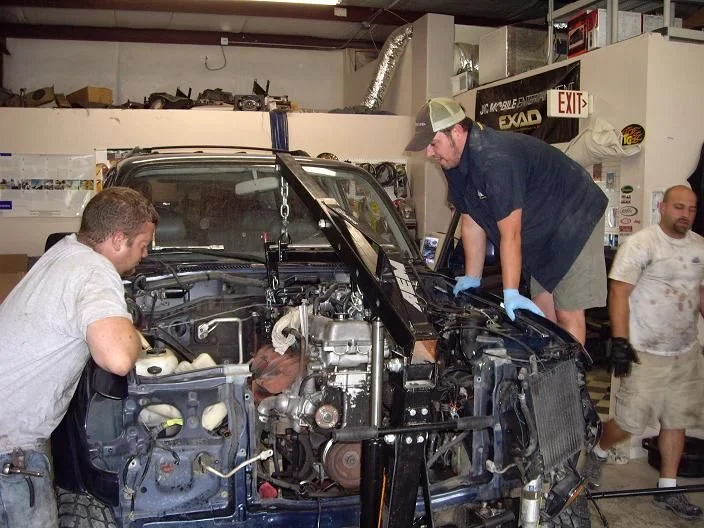

It is in, it is pretty much all hooked up, just a few doo dads to button up, wires not going where they should etc.... But hopefully we can get it startet soon!!! I have lots of pics, and will post them in the coming days....

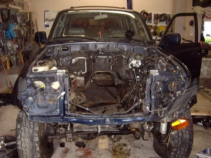

Here is one i took right after we got the motor/tranny/tc out of the truck.
