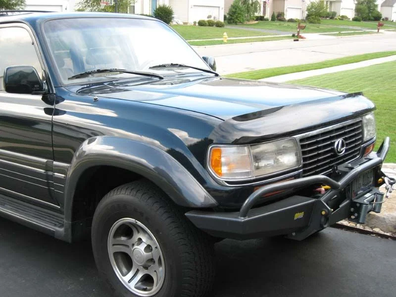

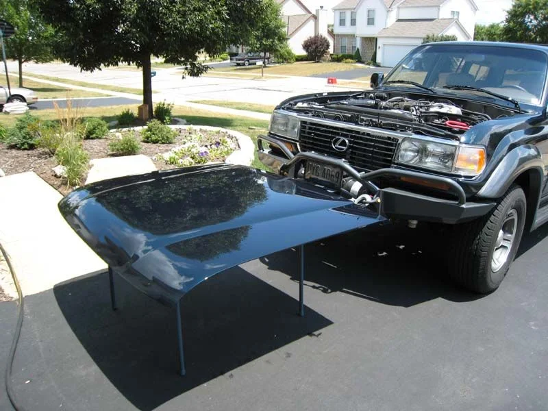

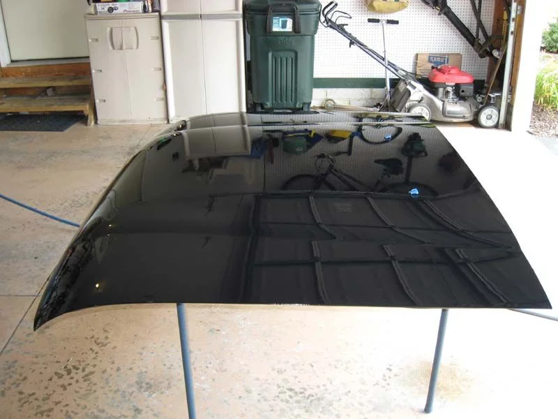

My hood was starting to look like hell. Lots of white streaks and spots and it was starting to detreriorate very quickly. Upon wiping it with some wax and grease remover, I noticed that the color was still there and is was just the clear coat fading. I went to NAPA, purchased a $30 can of automotive Clear Coat, removed the hood, wet sanded with 600 grit, buffed the hood and applied the clear coat. The total time involved was about 3 hours and $30 in materials + $10 for the neighbor kids help. I think it looks 100 times better now :)

Very nice! Now just keep a coat of wax (I will let you decide the brand) on there.
Nice work!

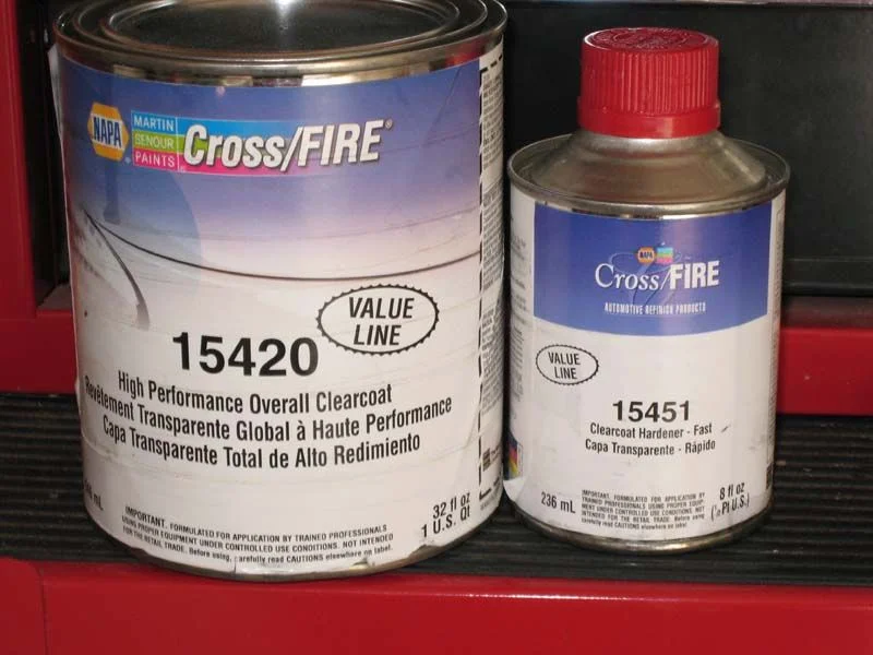

can you post the info on the clear coat?
brand?
is it only available at Napa's?

I usually use a 3 part mixture that is a little higher end. They were out of it, but the paint guy said that some guy who paints hotrods uses this stuff and gets really good results.

Yes I have painted before. Spraying Clear coat is a no brainer though. Just start out light, and increase fluid volume as needed. Try painting a trash can or something before doing your hood.
I have a 20 Gallon compressor, I used a $30 hvlp gun. My binks guns all need rebuilt.
Dry time between coats, 10 minutes. Total dry time is about 1 hour, let cure for about 4 hours before handling
I'd like to see it on the rig. Does the new clear coat clash with the rest of the vehicle?

I forgot to add, before painting, Wash hood thoroughly with Dawn Blue Dish detergent, LIGHTLY wet sand (I used mineral spirits) with 600 to etch, and pick up a can of Econo Prep at Napa. This is a wax and grease remover and can be used for you final tac with a clean cotton lint free cloth. Finally blow it off with an air gun. Cleanliness is is a must for painting. If there is dust on it, or residual grease or wax, it is going to look like hell. Before proceeding, you may want to visit the Paint and Body forum and get some tips form people that know more than me. Finally, if your application isn't perfect, you can probably take it to a detailer for a good buffing.
That looks great! You did a really nice job! Congrats on a great fix for little $$$. Thanks for the write up, too!
