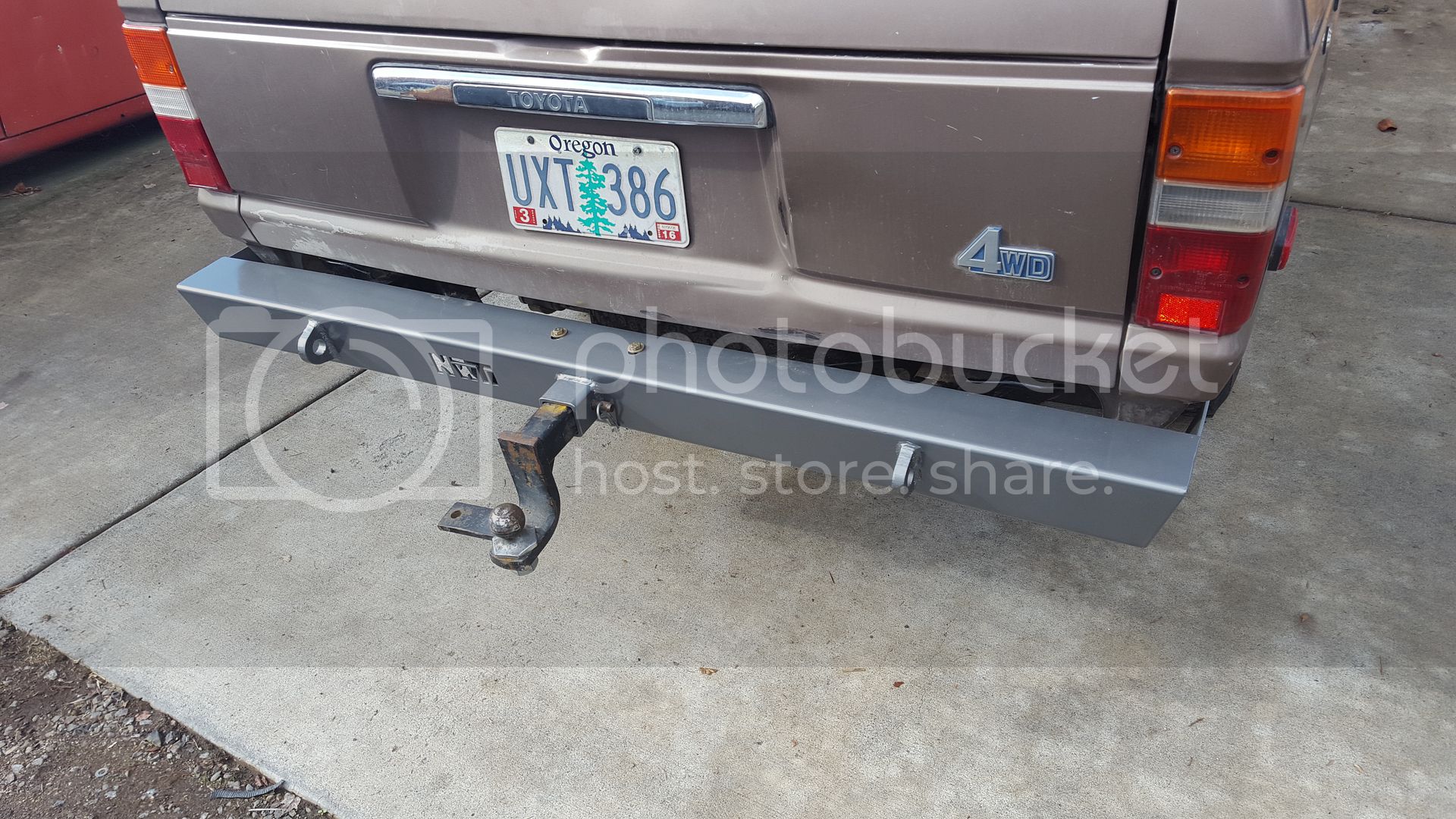

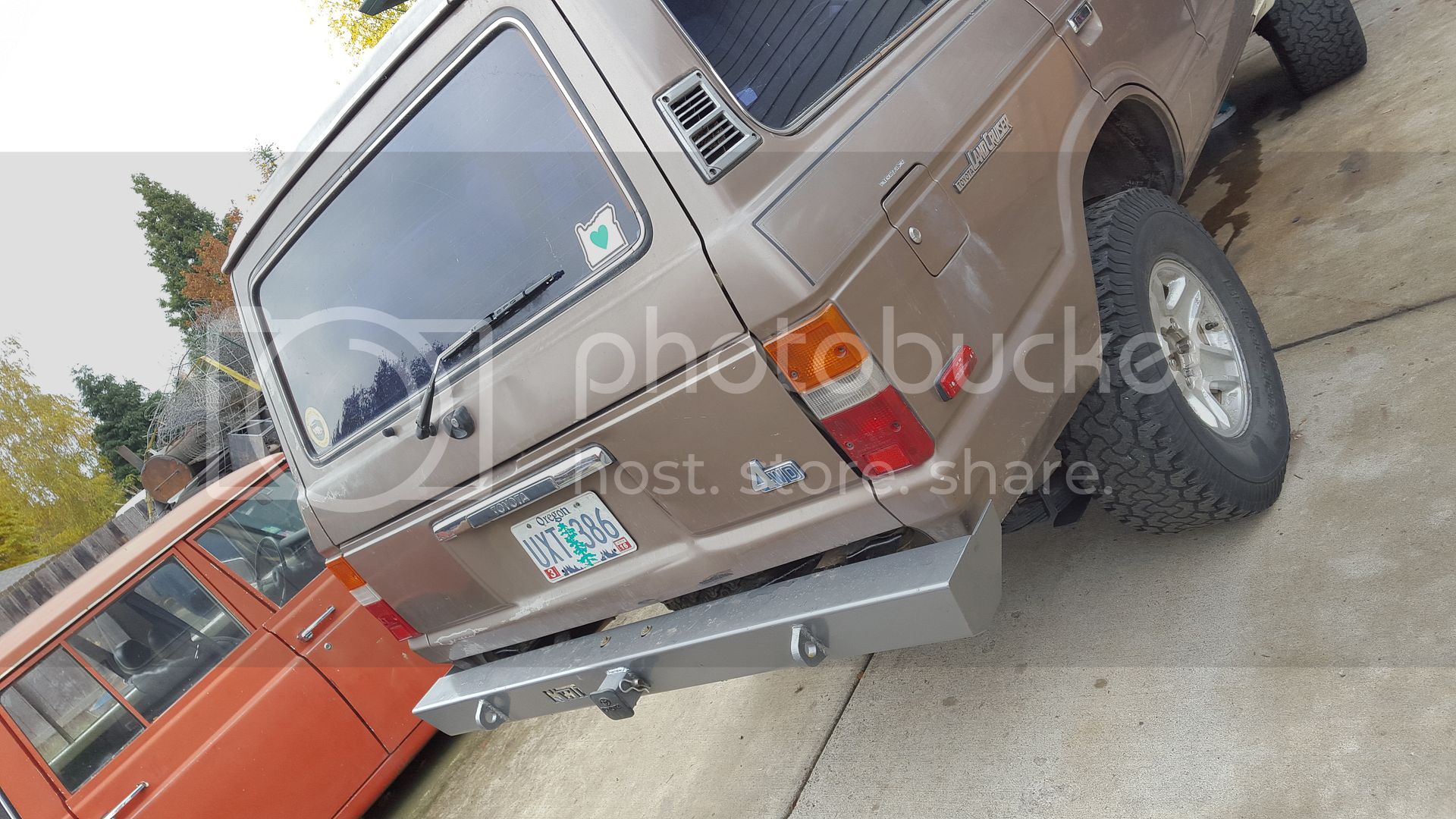

Rear bumper went together super easy. Maybe a couple hours of fitting and an hour of grinding/painting. My rear crossmember was bent so it took some persuasion with a BFH to get it to sit right. Basically everything is welded to those recovery points and then the bolts go through them and the frame, I made it so there was 5 grade 8 bolts on either side along with two in the middle for a total of 12. Granted the two middle ones are bolted to the rather unimpressive aforementioned crossmember. The bumper is not boxed but it will be good enough for protection and a little light duty towing and recovery. It probably only weighs 40 lbs or so.

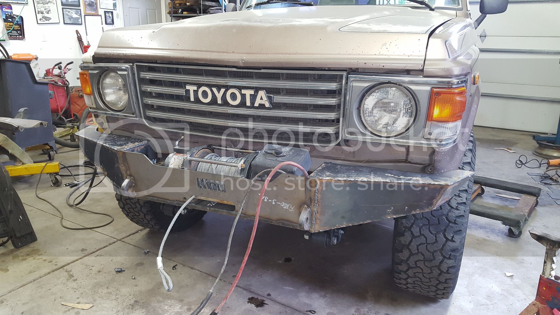

Front bumper was a little more involved. If you have a normal 8k winch you don't have to cut your valence but I was running a old school Warn 10k which evidently is a lot bigger than the 8 or 9k winches.
Again this was a weld together and there were probably 14 different pieces in various shapes and sizes. Took maybe 3-4 hours of aligning and tack welding and then another 2 hours of welding inside and out plus another 2 hours of finishing. It went together remarkably easy considering how many angles I had to get right. Also mounts with 12 grade 8 fasteners to the frame rails.
I like the profile of it and the approach angle is pretty darn good. Again you can see I had to cut the valence due to the giant badonk a donk on my winch (yes that's a scientific term). The wings are unboxed which means they won't hold up to severe wheeling but all in all probably more than I'll ever need. Front bumper might weight 70lbs, I was able to pick it up fairly easily with the winch installed which means it probably wasn't over 140lbs total.
