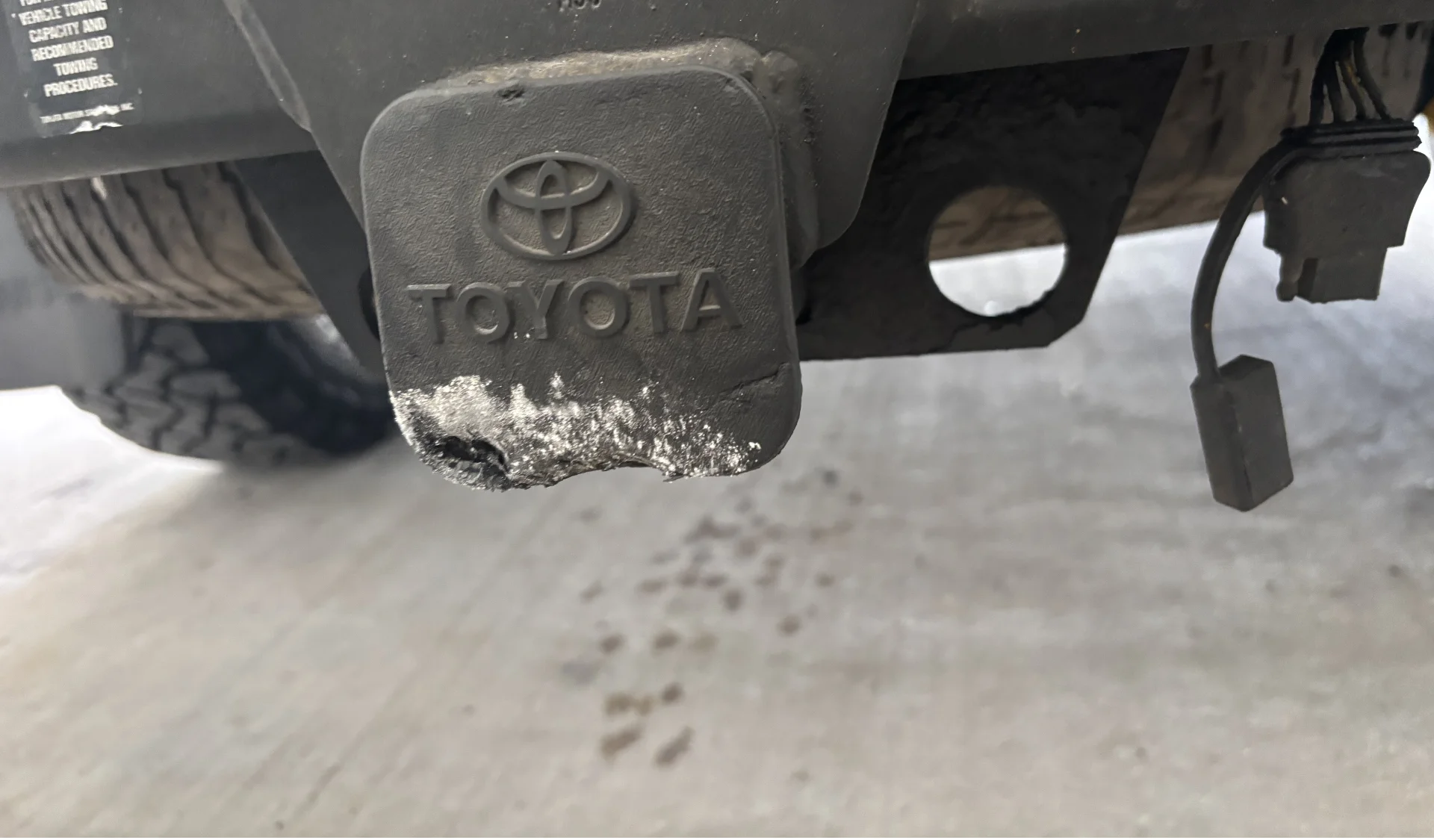

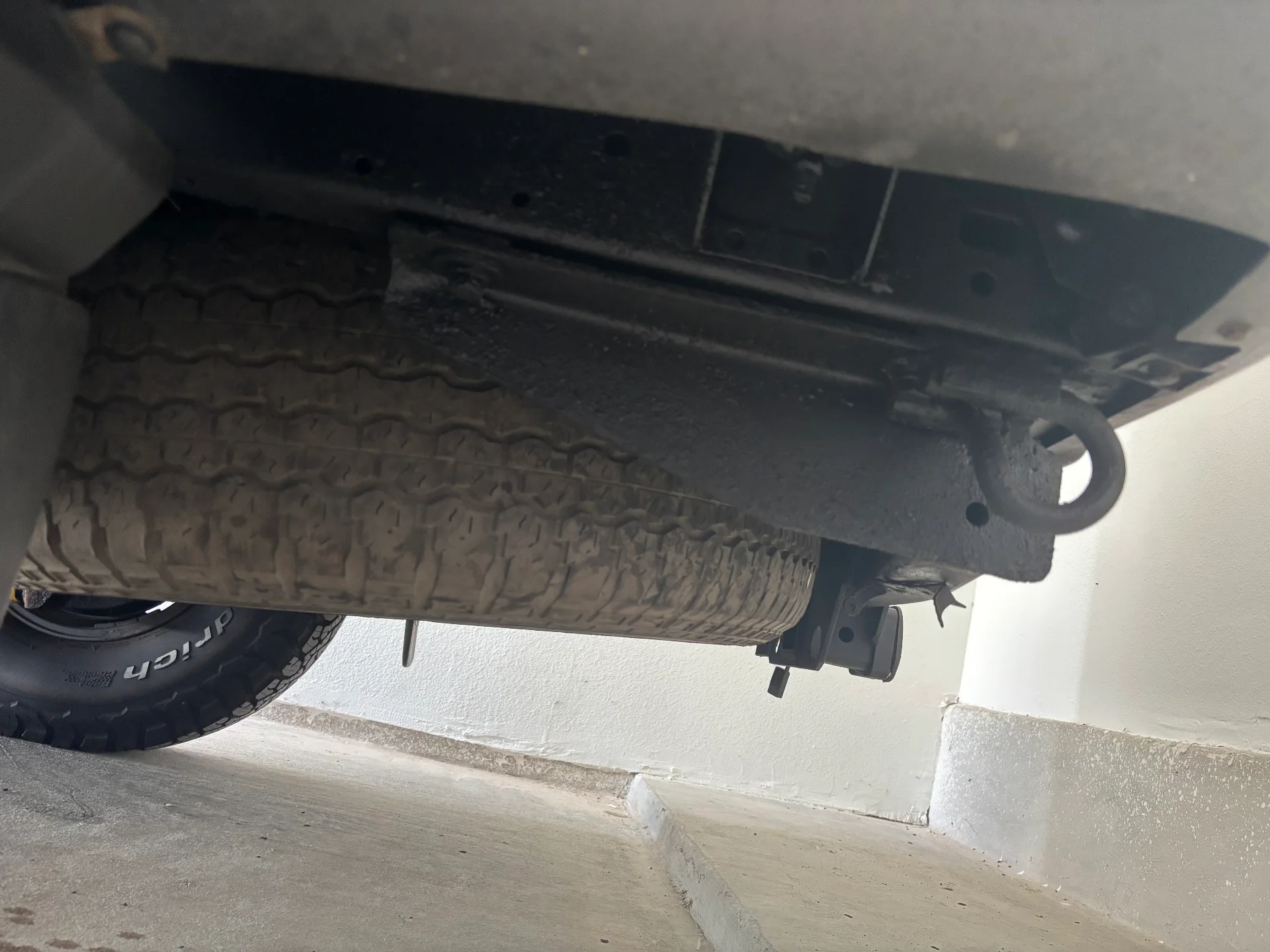

New to IH8MUD and the Land Cruiser scene in general, so apologies.
Backed my 80 Series into the garage today for the first time and accidentally bonked the garage wall at a coasting speed like a noob, hitch hit the wall. No damage besides the hitch, but wanted to see if there were any specific things I should look for damage-wise with the frame (Besides cracks) or if I don't need to worry at all. Thanks!

Forgot to add, did an initial glance check for any damage besides the hitch cover and didn't see any cracks.
Trailer hitch is attached directly to the frame. Check that the rails are true by measuring diagonally from two identical sets of points. Drive it like you stole it after that.
How about a picture of the damage? It’s unlikely the frame is damaged If you hit what ever going slowish.
You’re all good. If the tow hitch is bent visually I’d consider replacing it if you tow other than that maybe get that silly weather tech hitch bumper / step thing I’ll keep you safer when backing up at the mall 🤣
