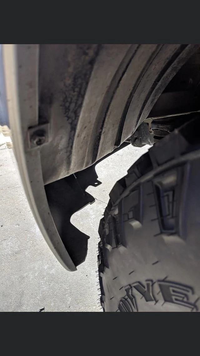

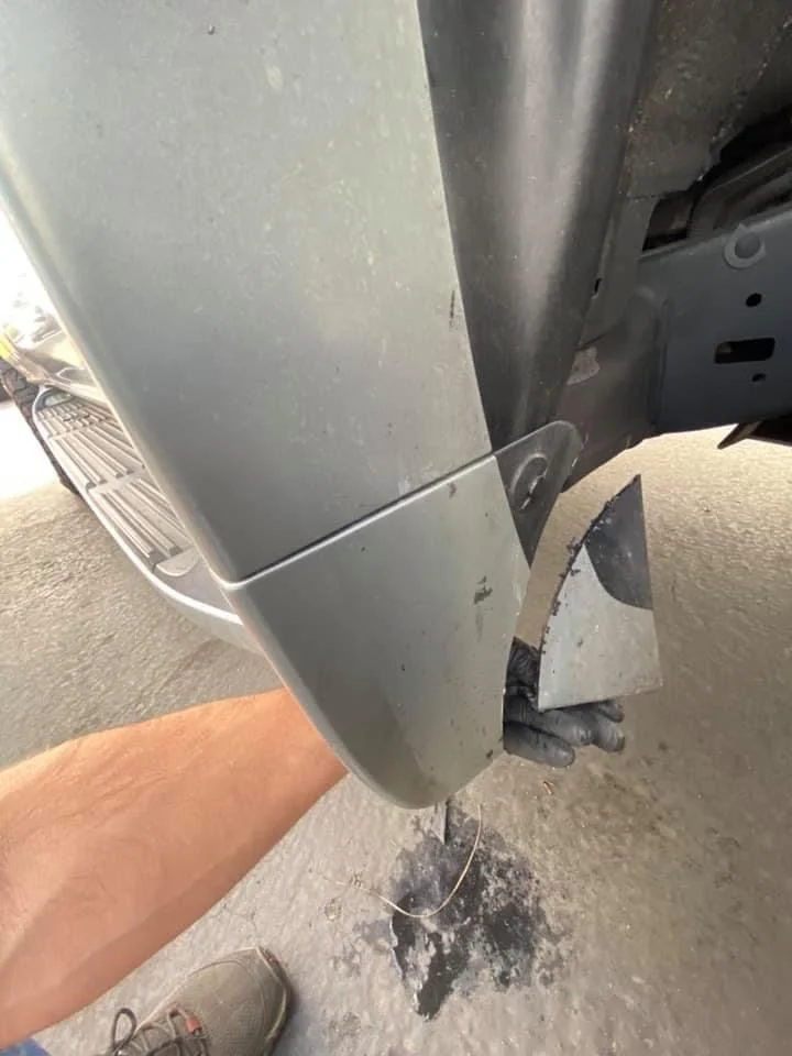

That should work. You could also get 265/70 or 255/75 duratrac or i know KO2 are stupid popular in Baja. And get E rated to protect against any flats or punctures but for these sizes you or your local tire shop might need to use a heat gun to bend the front fender liner in about an inch and trim a piece of plastic near the front of the running board to fit them with no rubbing. If you stick to 265/60r17 you should be able to fit any tire. The bigger sizes will better protect your wheels from potholes though.
Thanks, I got a heat gun and that plastic is going to get stretched.

255/80/17 are a perfect fit with no lift. You have to do some plastic trimming but in the end you have a true 33” tire.
