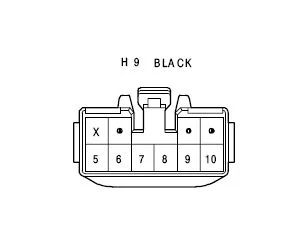

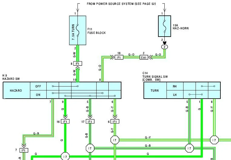

Tonight while the dash was open, I replaced the flasher relay, and hazard button. Still nothing? any ideas? when I press the hazard button the turn signal lights stop working but that’s it, no hazards. I checked the HAZ/Horn fuse also. I figure I have a wire messed up somewhere, but I am at the end of my electrical skills.
