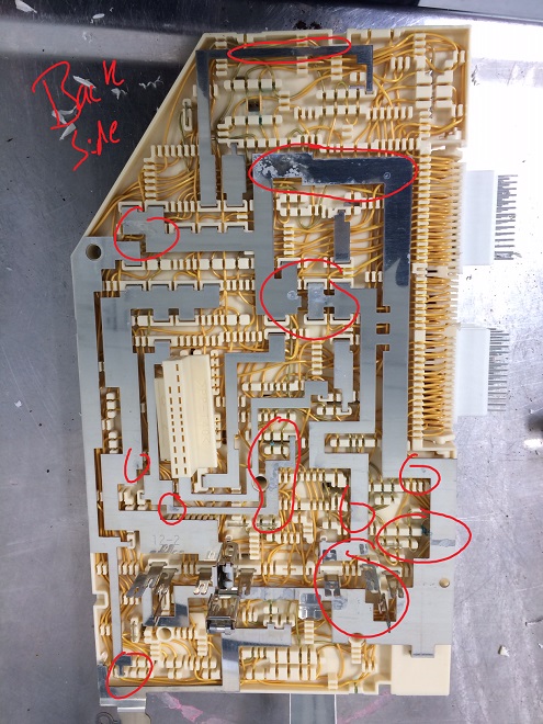

Following this. I'm having electrical issues that I fear were caused by a leak and resulting PCB corrosion. Does anyone have instructions on how to remove the driver's side junction box under the kick plate?

That's good to know. I still want to pull and check as much as possible since I have some things that don't work (key fob unlocking and alarm going off when using key), so something is dead. Before I throw in a new BCM or lock controller I wanted to further diagnose.
Also need to get the windshield re-sealed. I have some rust bubbles on the A pillar which I recently fixed but I fear what I'm going to see when the windshield comes off...
