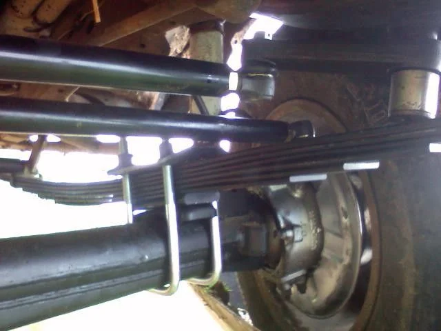

RUF- Used an 84 spring pack, removed overload leaf, first 3 leaves of 81 pack used, each cut down three inches from another. Cut down an overload to space the driver side. Used the original metal insert in spring by pressing out the bolt from the alignment sleeve (is that the name?) on the front mounts, slid in a G8 14mm 5” for a perfect fit.

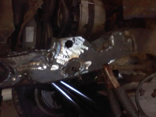

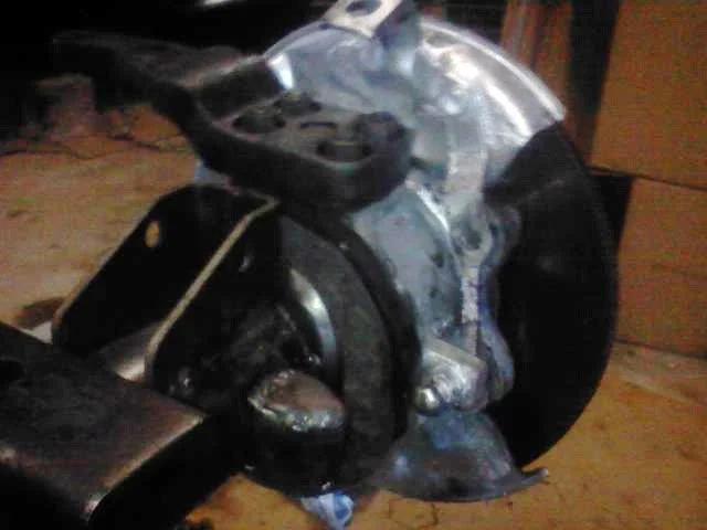

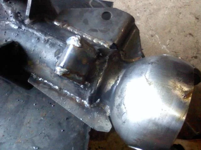

Lastly, a pic of my short/quick welds for my knuckle gusset... I gotta a little to far on one side and it barely bumps my knuckle.

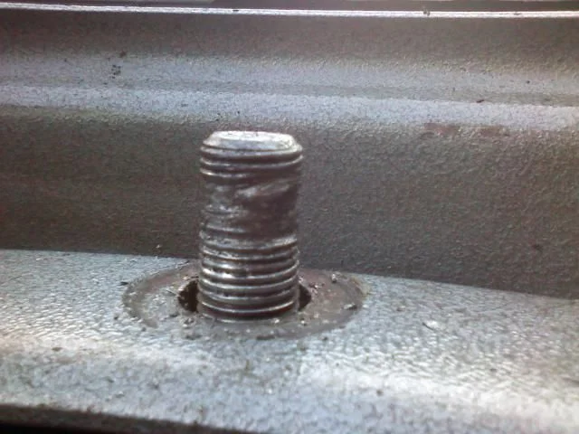

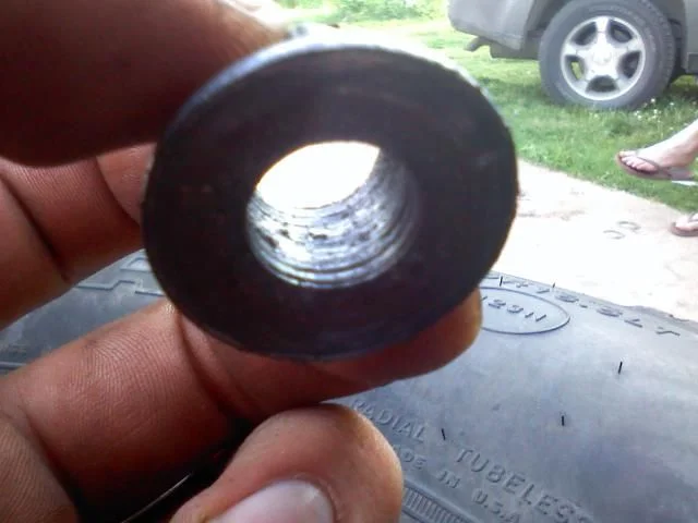

First 3 went smoothly. Took my time on the first one, second one took 15 min, 3rd 11 minutes... 4th, not so good. I ran into a difficult nut on the rim, so i soaked it in some penetrate oil while I ran the other 7 bolts off. Went back to it, it zoomed right off. Heres why.

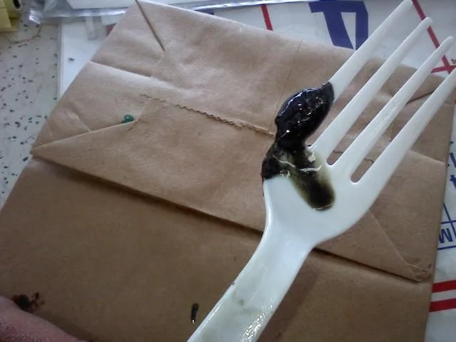

Changed the diff fluid today, they are officially broke in!
Heres the metal from the rear... Is this the normal amount of shavings in the diff after the first 500 miles?

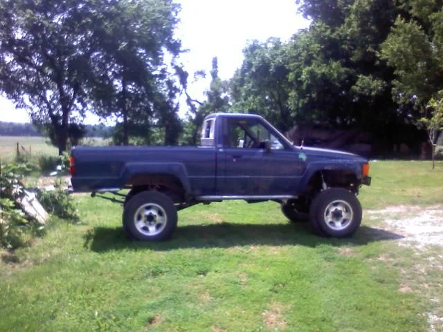

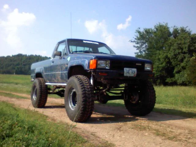

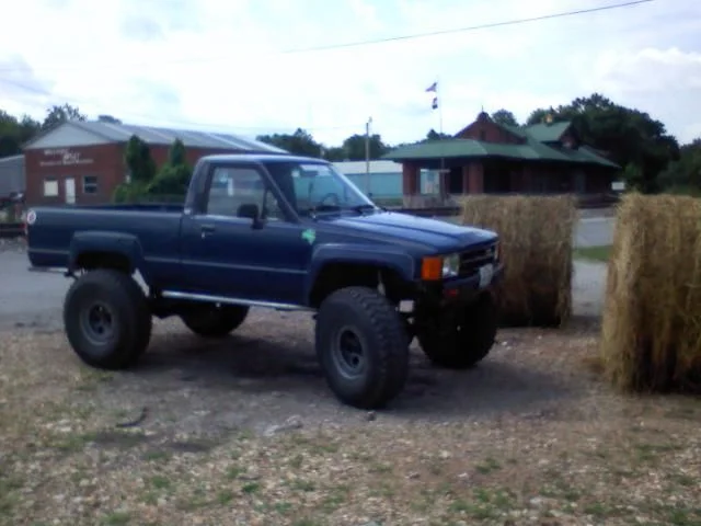

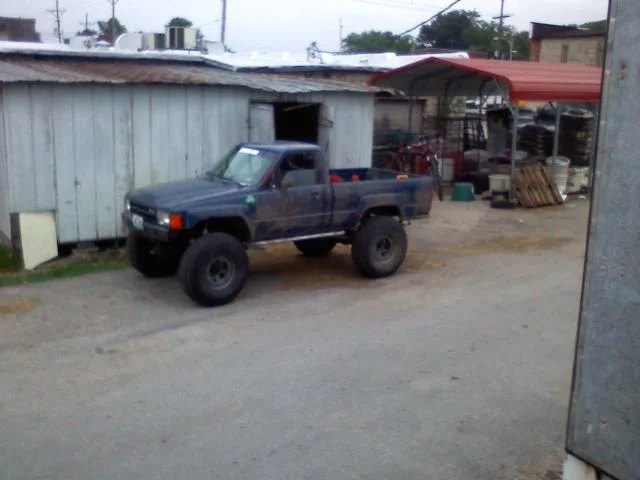

Pics, cause you guys have waited long enough...
And another so i dont' look like a mall crawler.
Btw- I live in the country, most the pics are from our feed store in town. I would NEVER live near that much blacktop.
