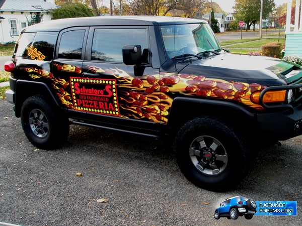

I bought an 07 FJC, fell asleep and wrecked it How 2 crash an FJI walked away uninjured except for some airbag dust blindness. The insurance ended up getting me an 07 TRD I started wheeling it some, remembering how much fun it was back in the day and decided that wheeling just got much higher on the priority list. I built up the FJC, drove it cross country to the 1st FJC Summit, then Moab, sleeping in the truck there and back, with me, my fiancee at the time and my dog. I wheeled the FJC for a couple years and kinda lost interest, the FJC was just not capable enough without a SAS and Lefty, Being my daily driver it wasnt what I wanted to do, so it became the Flaming Pepperoni cruiser
