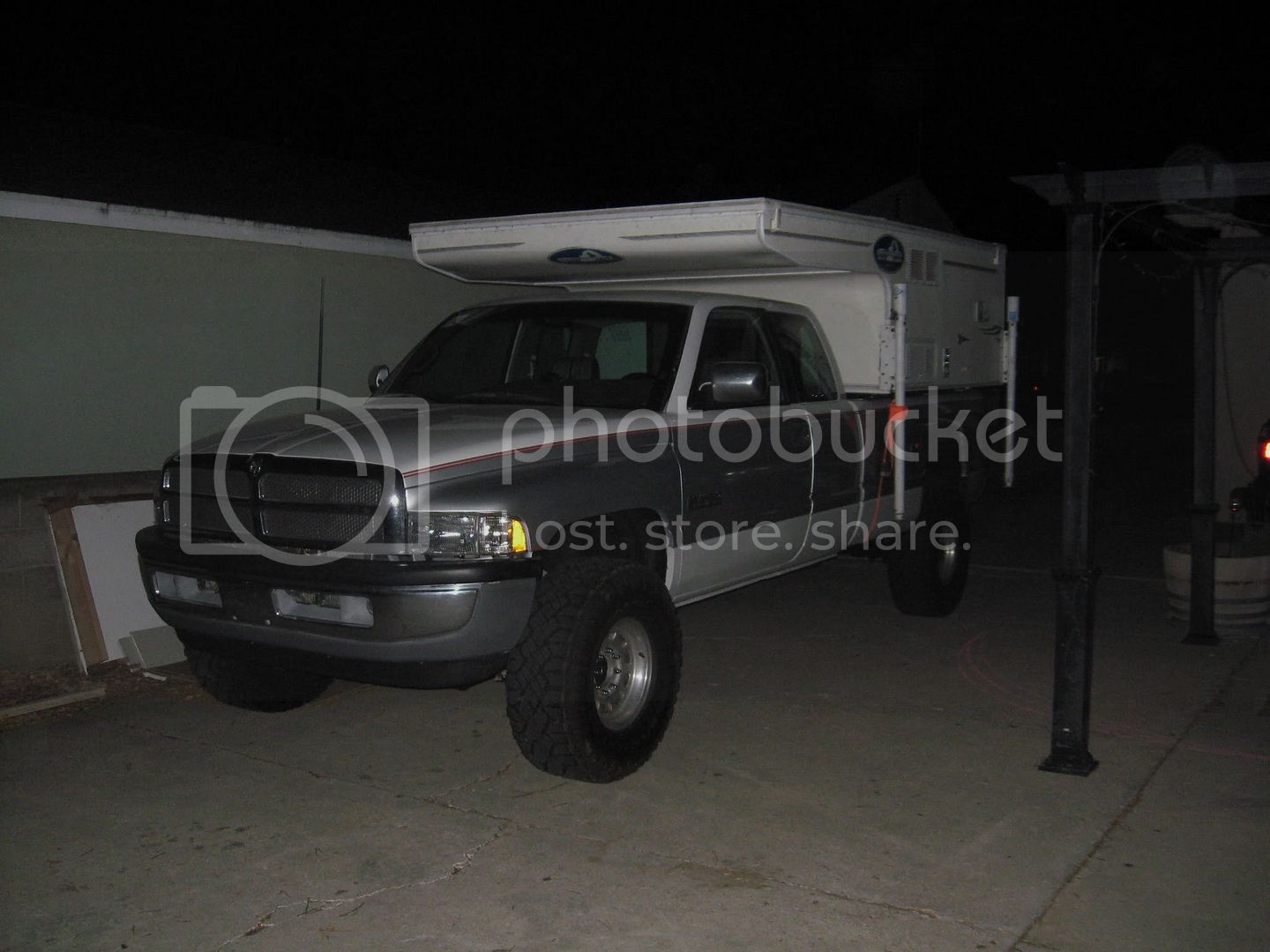

'96 CTD Club/Long w/ Phoenix pop-top camper:
http://i168.photobucket.com/albums/u196/ntsqd/95 CTD/IMG_0433.jpg
Almost no bed mount options unless I string ~12' of coax under the truck to get to the tailgate. And then not much ground plane would be available.
Maybe I have too finite of an idea of "ground plane", but to me that means either perpendicular surface or perpendicular radials of a certain distance or length around the base of the antenna. Anything less is a performance loss. In 2M what I'm finding is 19" radially. There isn't an area that big available except for the hood and the camper roof - both of which I'd rather avoid for various reasons.

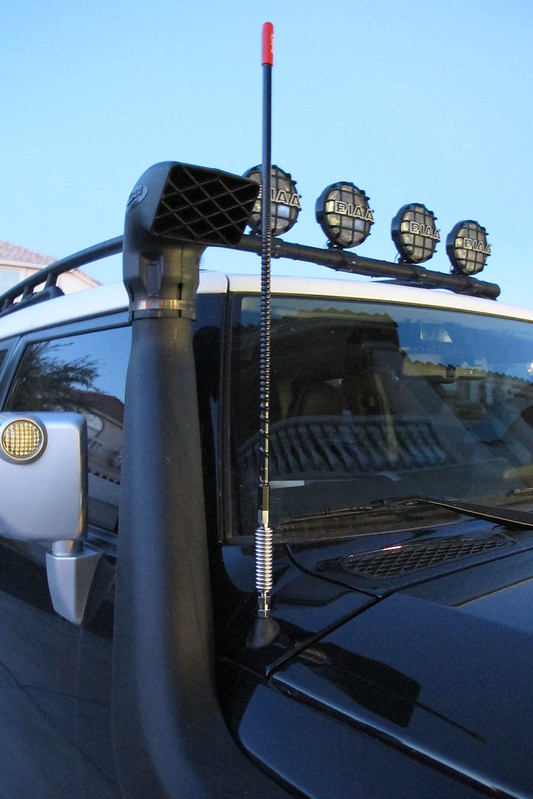

Looking at your rig, "If" this were mine to fix, what I would do would be to replace the AM/FM antenna with the 2M antenna. Like this one:
OR/and add the FM or 2M to the other side. It would take a little fabrication, but honestly I would do that in a heart beat. Makes for a good ground plane and a nice look as well.
I do something like that for people that want to use the same antenna for their CB radio:
