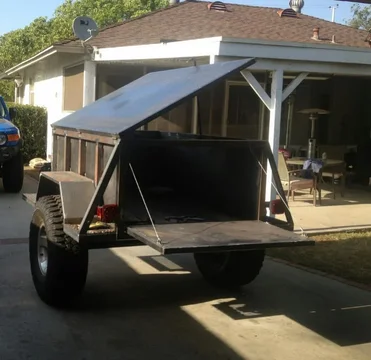

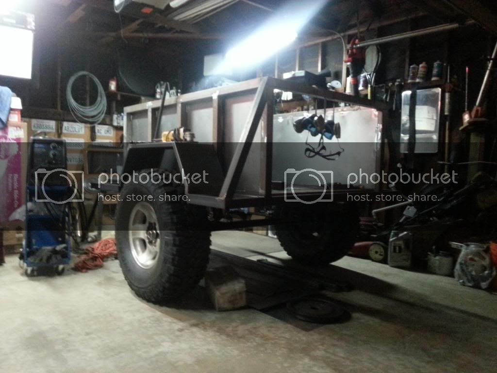

Sneak peek of the next project. It has taken a loooooong time to get to this point. Family obligations and other hobbies seem to come up frequently. My buddy twelve1 is doing the fab work mostly from scratch. He wants to get this completed and out to make room for his project 78 FJ40.
I am pretty much handy with a grinder :cool:. Hoping to wire up lights, complete tailgate and start the lid soon. Once we wire up the brake lights it's DMV verification time. Got to think about paint...rattle can? Earl Scheib or powder coat it:hhmm:

That garage looks mighty familiar. I think I've been there before too. :p
Hahaa hey Joey! Yeah thats James garage. His 40 needs attention.

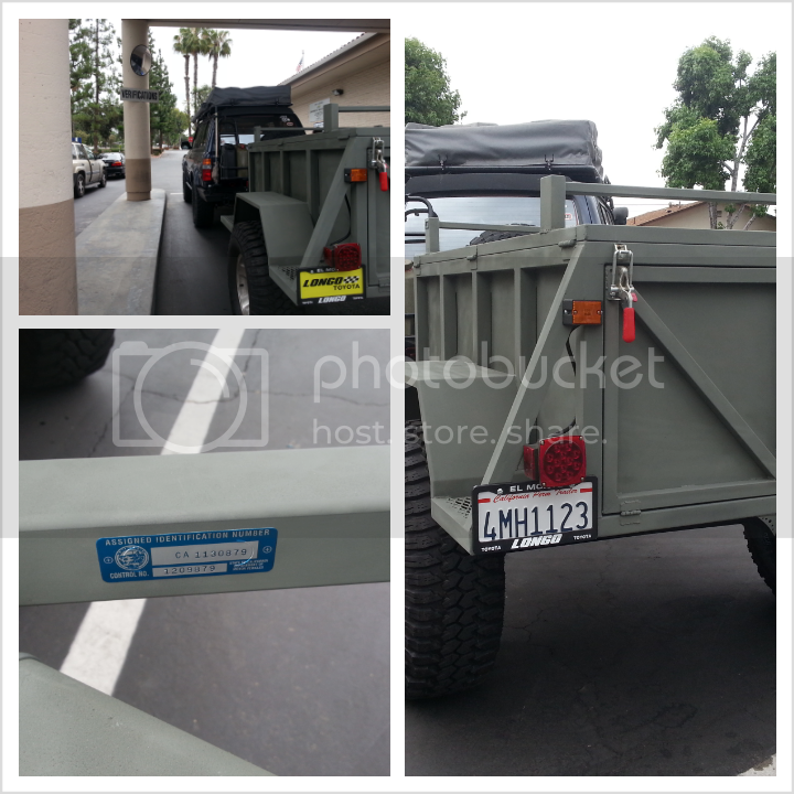

Got this bad boy verified and registered! Still need to do a few things, Not sure where the maiden voyage will be just yet.
Free Longo publicity
