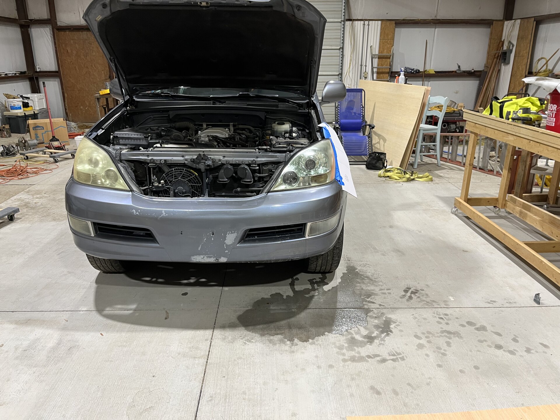

Got tags and insurance yesterday. Weld nuts were stripped out in the tailgate, I had to pull the back panel and put a pair of vise grips on from the inside. I didn't JB weld them or replace, so I guess my tags are semi permanent. I got my denso radiator from Summit, Rockauto was going to charge $50 shipping for radiator, hoses, and thermostat. Hopefully going with summit was not a mistake
