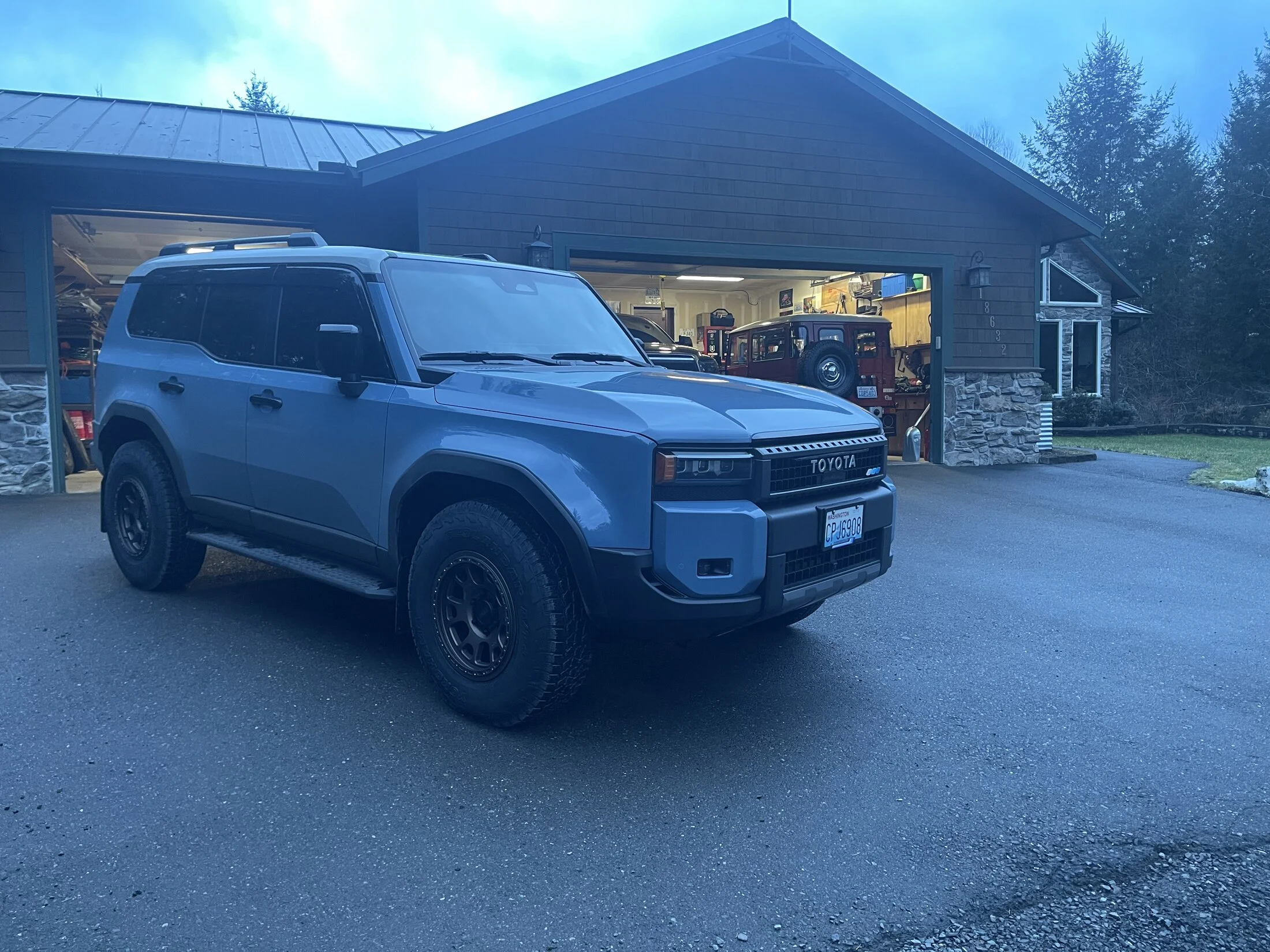

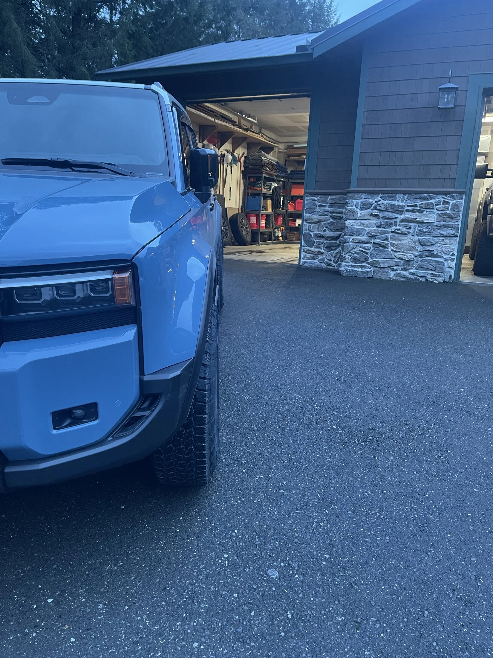

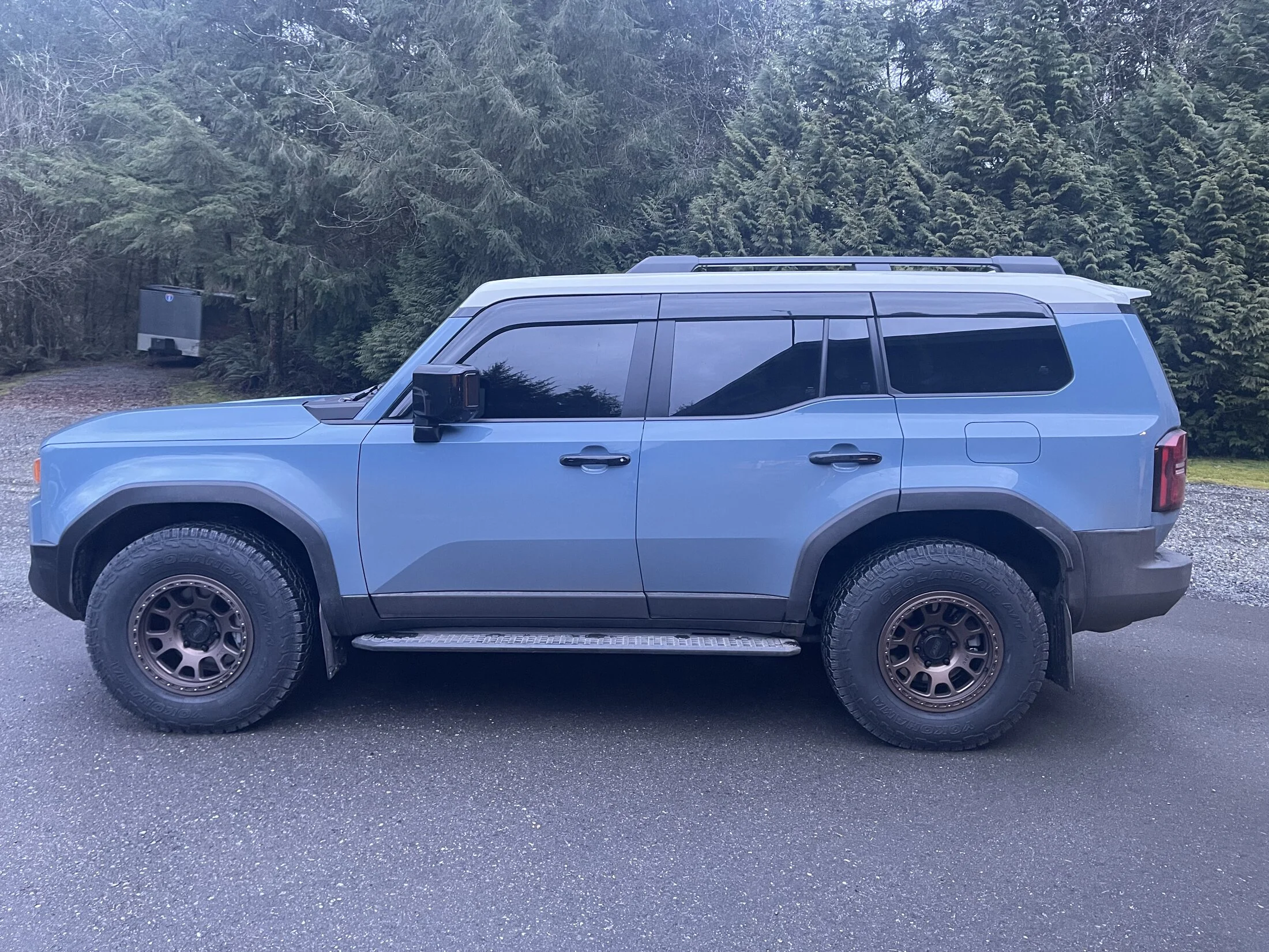

New pizza cutters:
Yokohama Geolandar G018 in 255/80R17 (52lbs.)
Wheels: Matte Bronze RRW RR5-H Flow form 17x8.5 ET +25mm (25lbs.)
Lugs: Extended lugs (11.1 oz.) vs OEM lugs at 1lb 7.4oz.
Loss of 12.3 oz. Per wheel, will be a near net zero gain once my bead lock rings come in at about plus 1.5 lbs. per.
Corners better on road and noticeably softer ride due to more sidewall.
Had OEM 20” with Yoko Geo X-CV at 77lbs. Per.

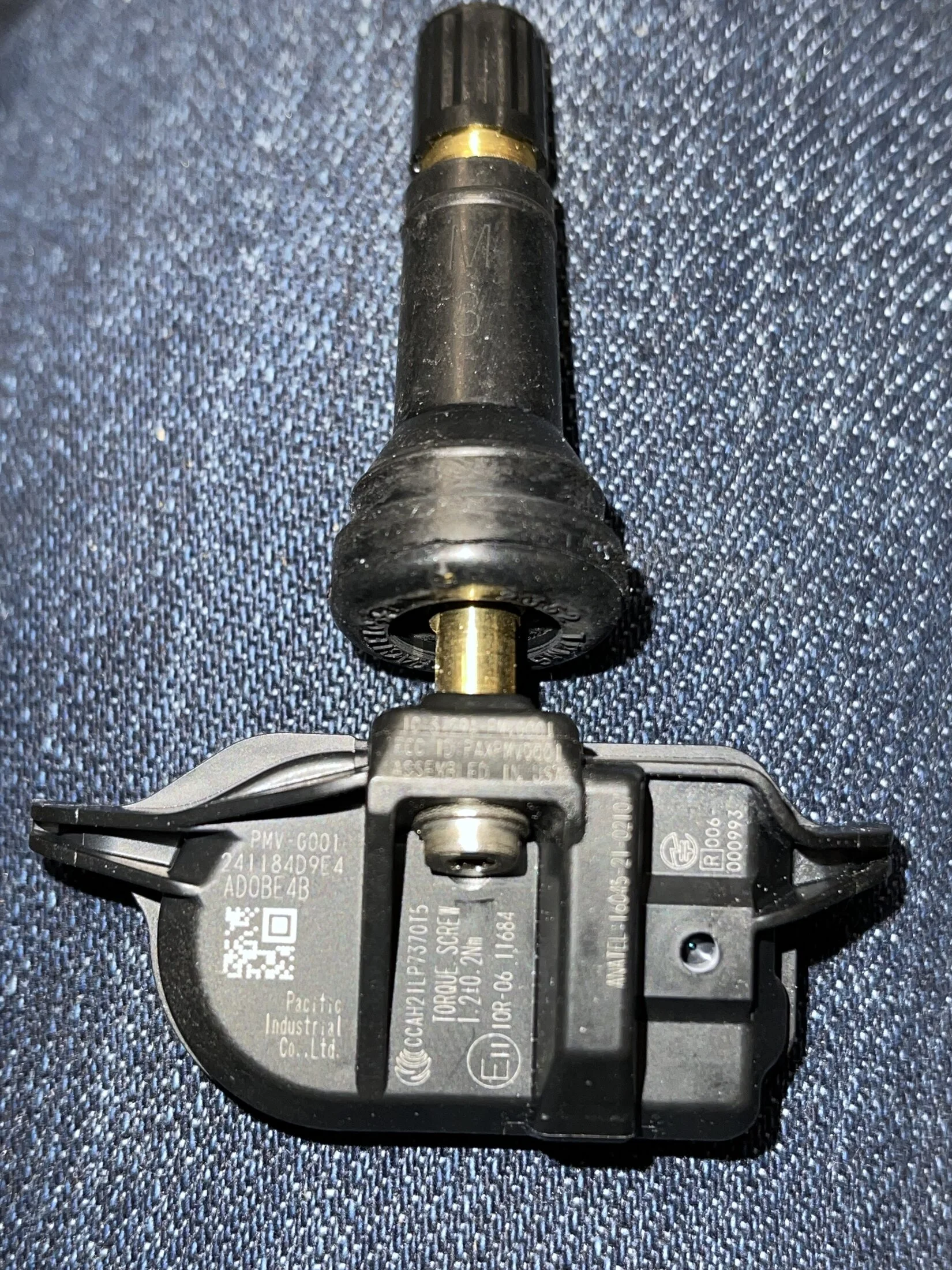

TPMS is same as Tacoma, I ordered that p/n as it was cheaper and is the Pacific sensor PMV-G0001
Toyota: 42607-0E090 (EBay for $50.00)
TPMS sensor also works on 17x7.5J ET60 Tacoma OEM steel wheels: 42601-AK031 (Black) this will be my spare once it comes in from Toyota.
The Tacoma OEM steelie is confirmed, I’ll be using for the spare.
