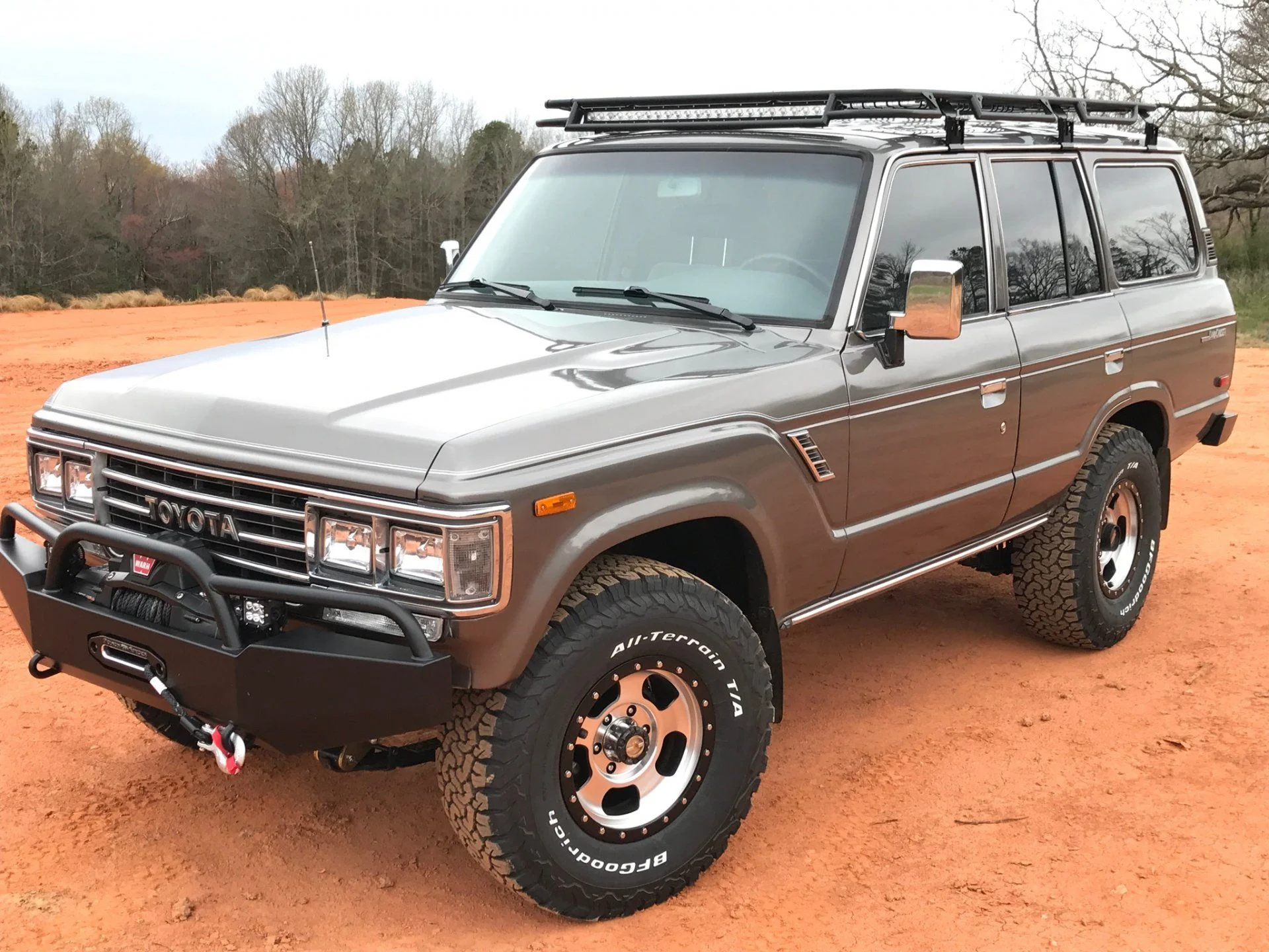

I just put a 10-s on my 62. It's a tight fit and the bumper had to be modified slightly. The instal shop said they have had to modify just about all the bumpers a bit to fit. But once in it looks great. I haven't had a chance to put it to real use yet.

Going to install it on my FJ60 ARB BULL BAR
That looks great.. is that a 4+ bumper?
