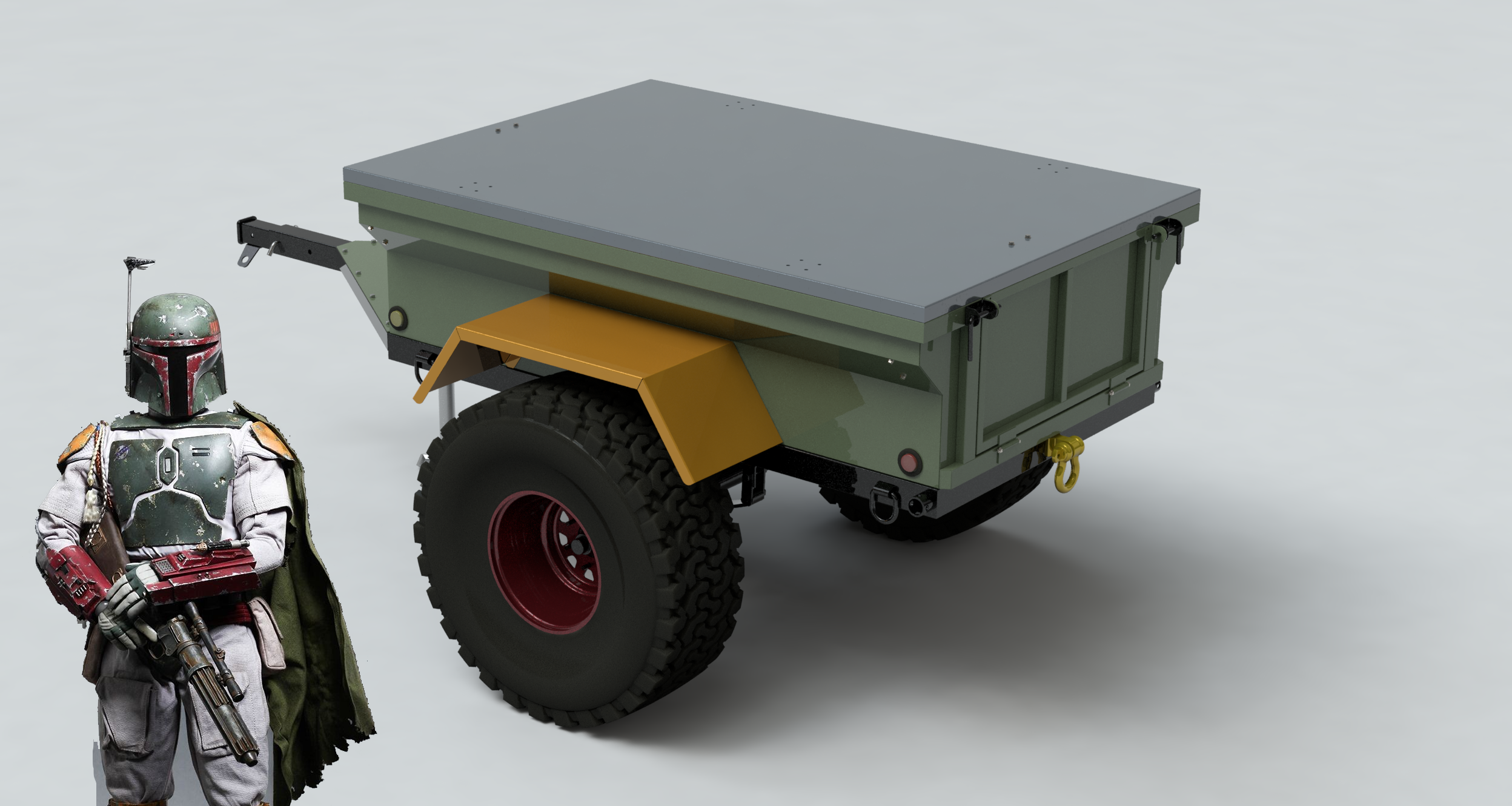

I think the next trailer I build, (starting in Jan 2018), will be called "Fett" and will follow this paint scheme.
This is a trailer design I mocked up in Autodesk Inventor and rendered in MODO.
I guess I should paint it, then scuff it up and bang in dents with the 2lb. hammer, lol
I would suggest tailgate latches that go over-center or have a cam-action. Simple pins thru a hole will wallow out their holes and rattle. If you can find them, the tail-gate latches from a Datsun PL720 pick-up or a Chevy 'LUV' pick-up or possibly those from a Toyota Stout are all over-center designs. Could also use De-Sta-Co clamp variations.
