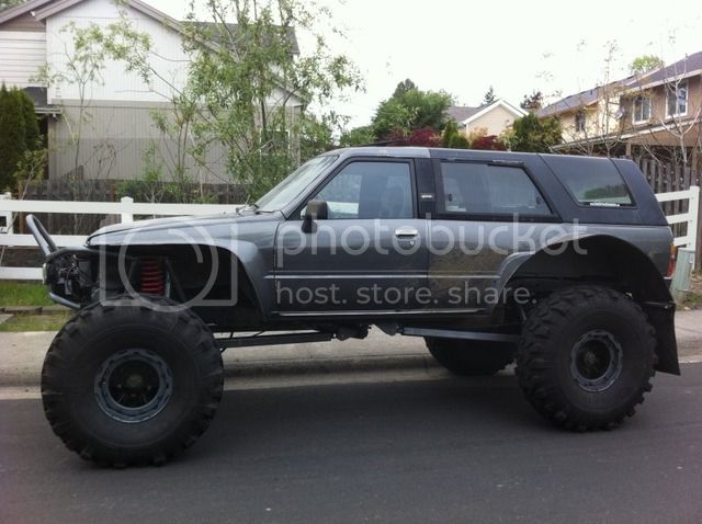

I'm in Oregon near Portland, and I am 95% done building a 1988 4runner. Here are the specs:
*1988 Toyota 4Runner
*1989 Toyota Supra 7MGTE tubro I-6
*R154/R150 hybrid transmission
*Dual transfer cases
*Unimog 404 axles, stock lockers and 7.56:1 gears
*Rogue Fabrication recentered H1 beadlocks with 42'' TSLs
I still have to replace a bearing in my chain drive T case, make a rear bumper, finish up my front locker cable install, and do a few other odds and ends. Oh and double the boost on my motor!

p.s. I'm curious how you solved the axle wrap on the front end when you jump on the skinny pedal. That engine throws plenty of torque without a turbo. :D

Oh and I have links, so no real way to get axle wrap. I handle the torque with 12" of end link separation on the rear axle (9 on the front). I have burned out one of my 42's on dry pavement without carnage yet...
And my shocks are staggered, driver's side in front of axle and passenger in rear. But with links, that rdoesn't really matter much.
