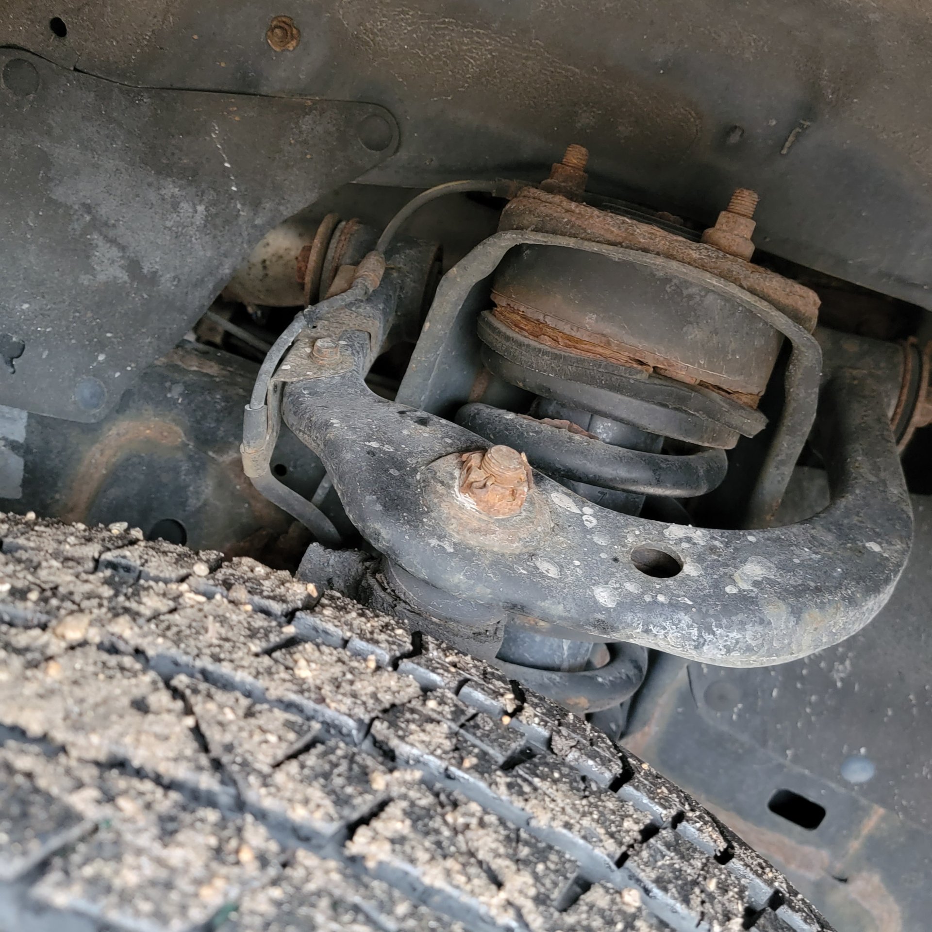

If I'm being nitpicky on things I'd like to change. The interior drivers arm rest needs to be replaced. Drivers door has to be SLAMMED shut or it won't latch. There's a thunk that can be heard when going over uneven pavement and sometimes on turns. It's lifted more in the front than the back somehow. Not sure if it's a spring upgrade or perhaps pucks of some kind? Im unaware if it's had its 100k mile Timing Belt and Water Pump change yet. I'll provide pictures. My first ever V8 and the newest Toyota I've owned.
Is the arm rest loose? If so remove it and check, it may just need the proper torque to fix it (happened to both of mine).
If you don’t know of the vehicles maintenance 100% have the timing belt, components and water pump replaced along with the upper and lower ball joints. This is a big safety/maintenance item on this trucks and the popping noise may well be one of the ball joints. If it fails expect a very very bad day.
The front is definitely lifted. May just be a spacer lift, but it is lifted.

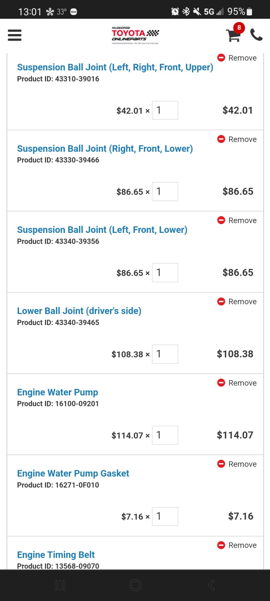

This look right? Seems they have different names but all similarly priced as far as the Ball Joints go.
Likely. Just make sure you go with OEM ball joints and replace the lower retaining bolts as well. I’ve seen old joints/new aftermarket and reused bolts fail.
OEM Toyota parts and OCD run deep ever since I got my Land Cruiser, so I will feed this gigantic thing the same. The parts should get here either Friday or Saturday. Sucks I bought this in between holidays. I'll take more pictures and everything Friday when I'm off. I'm going to baby it until then. I don't want these failing on me. I will do the timing belt in the spring when my 80 is out of storage. I don't drive much. 5-6,000 miles a year out of my DDs in the past.

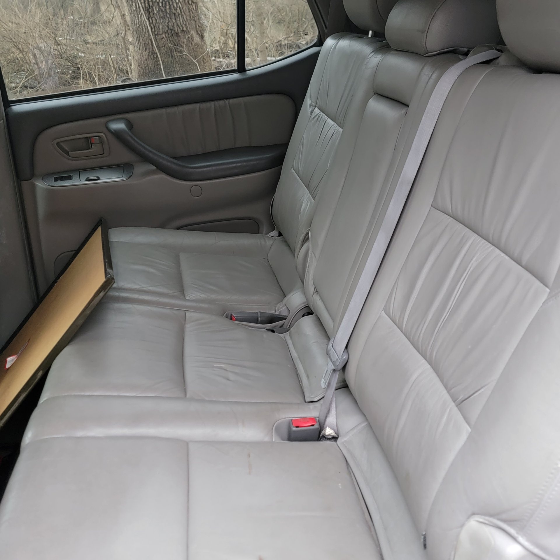

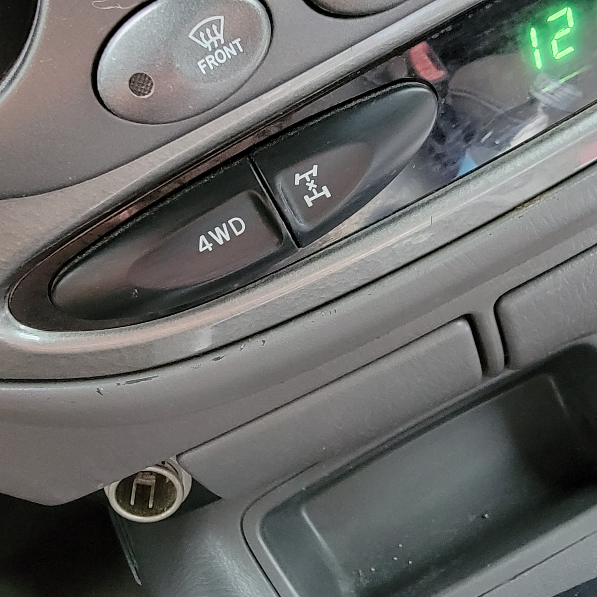

Interior. Not as bad as one would expect. Two owners. This is a DD/work truck. So the approach will be much different than my 80 was. Might keep the leather as is. Not sure if there are any replacement kits out there. I want to get the OEM radio instead of the Kenwood I have. Also have to replace the antenna. Love a 4x4 lever.

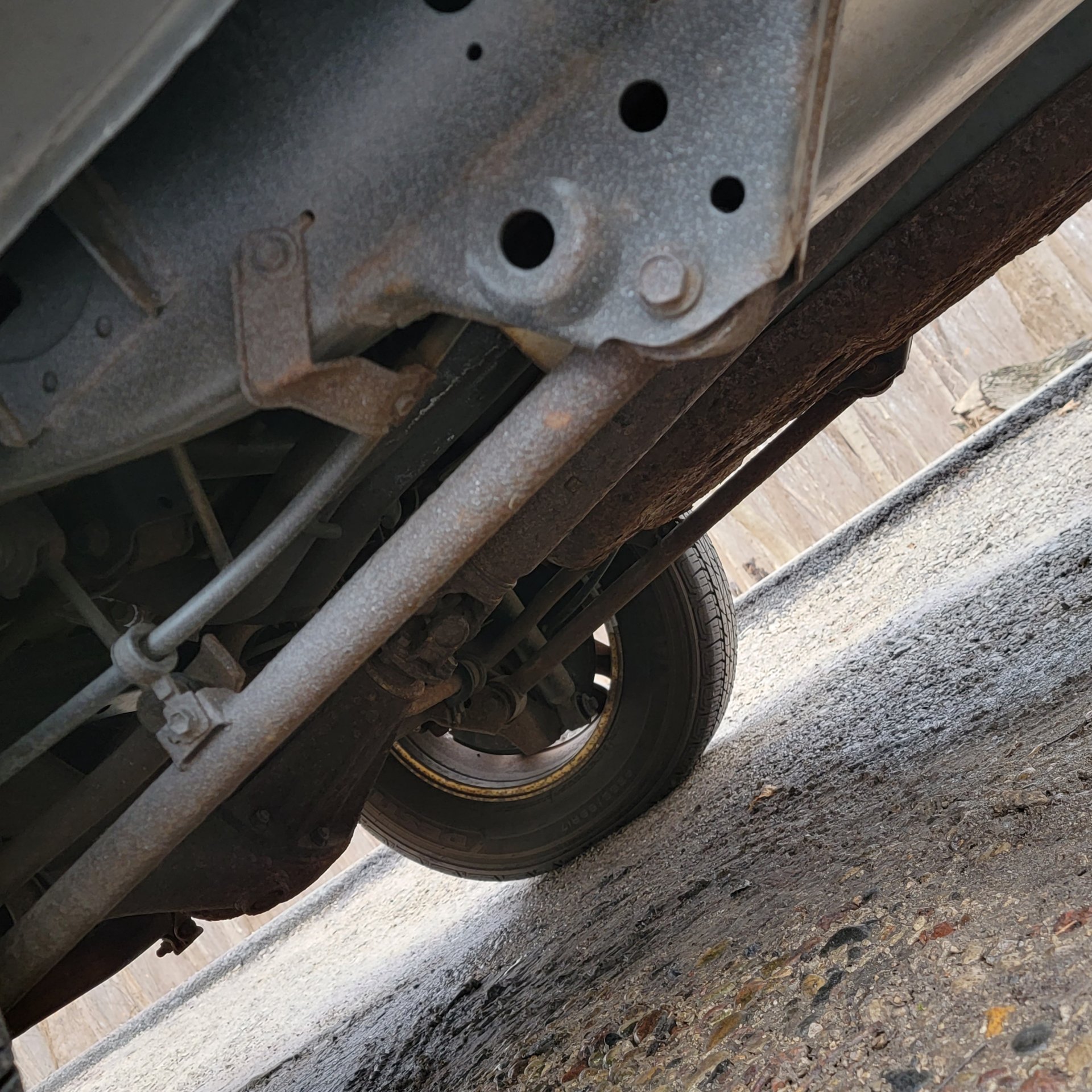

The underbelly. Started life in Georgia and the Carolinas before moving to the rust belt. It's not perfect, but for the price I paid, I'd say I did great. Especially in this market. I will spray the underside with Fluid Film. Oh is that the Fuel Tank Skid that's basically rusted out?
