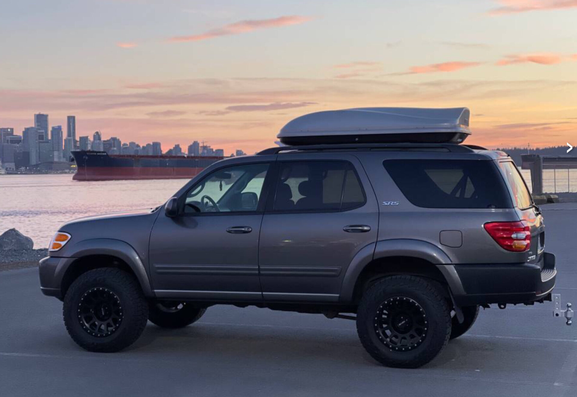

Make sure you post more photos when you get the new leaf packs in. My rears are a bit too tall, so I think your 1.75“ will be great. You can see I have a bit of rake.
