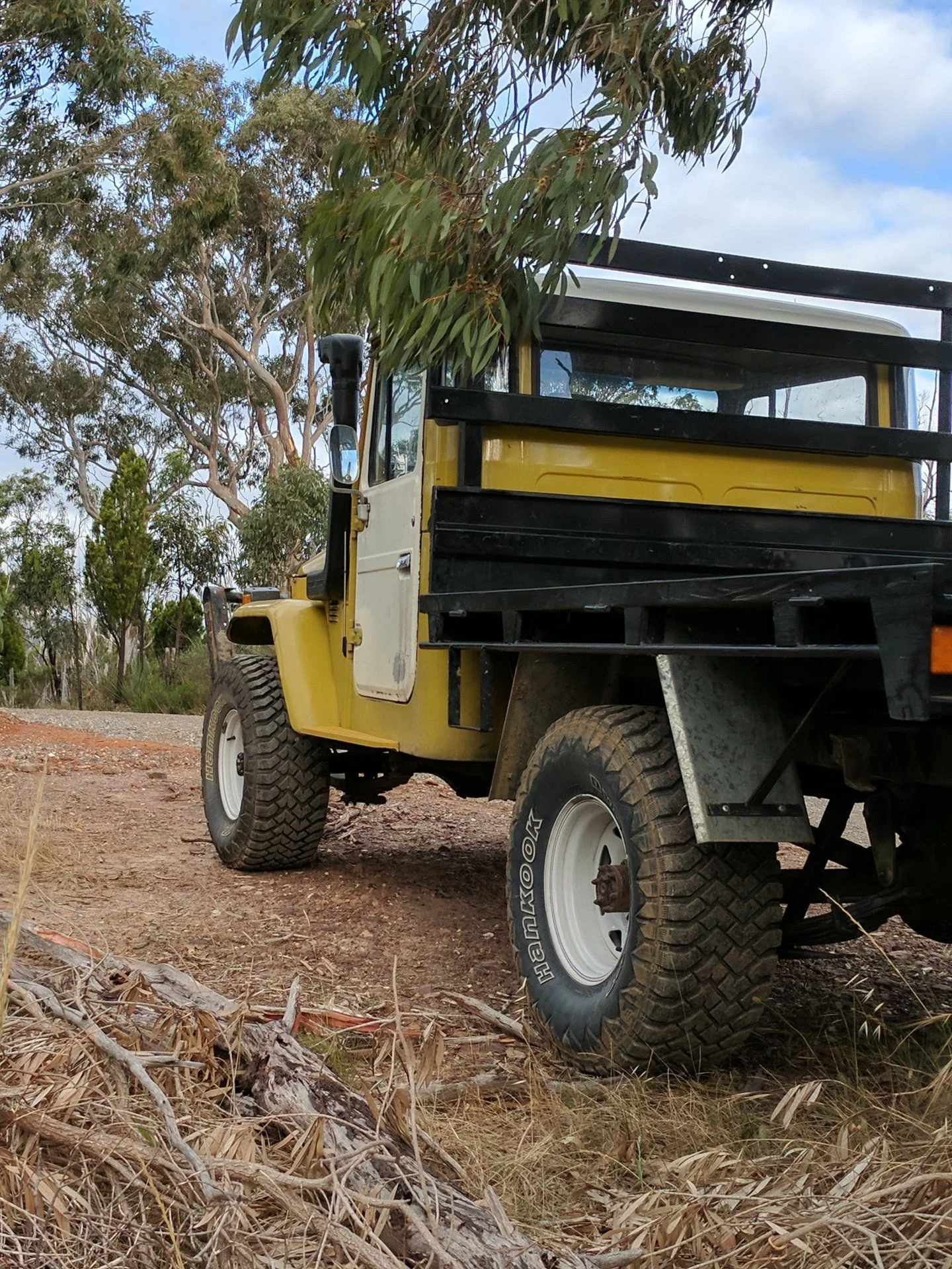

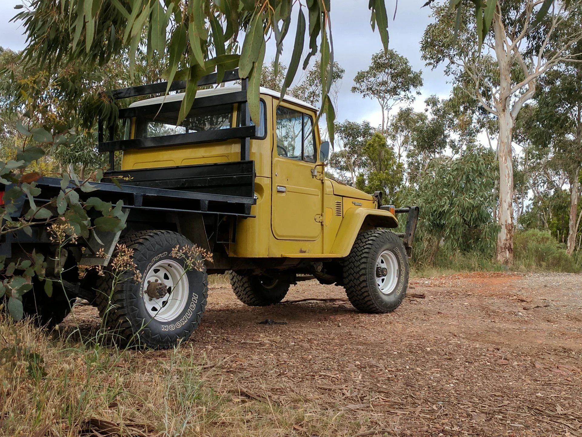

Hey welcome back into the cruiser business :) she looks like a really neat truck that you have there nice score. It looks like it has had a repaint at some stage?
Also, just a bit of personal preference here but i reckon that white rims lools better than black rims on the old 40s. I had a mustard 40 and the new owner has gone back to black rims. I reckon that it looks terrible. Hey at the end of the day everyone has a different opinion but i have attached some pics of my old 40 so see what u think. Cheers
Yeah there's the odd brown stain starting to appear outa joins in the odd spot, but is remarkably clean compared to most (all) I looked at when shopping for one.
Re wheels, there'll be some new steels on the cards at some stage, not a big fan of the white though.
