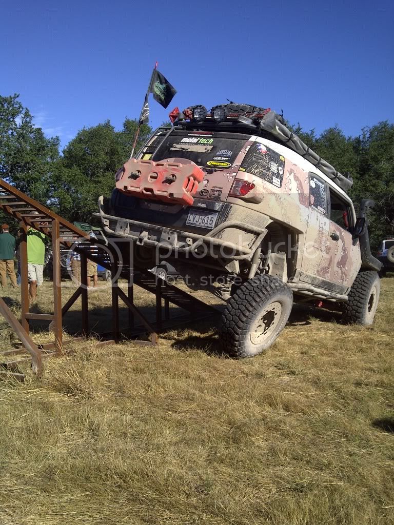

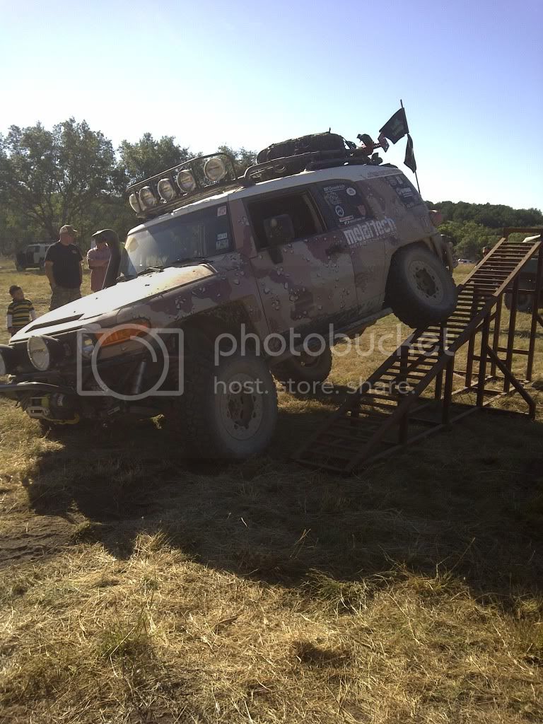

Got it on the RTI ramp this weekend with the new shock and coil combo
Rear Score 943
Front Score 872
