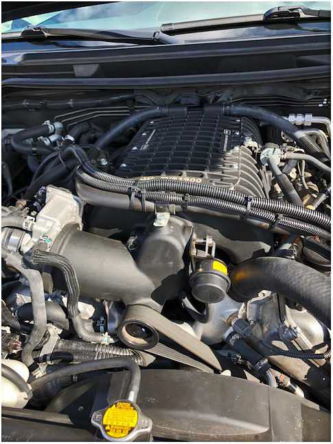

My plan was to install the BP51's and sell the almost new Biltsteins (still available), put a set of storage drawers in the rear, lock the front and rear, and install a winch. I was up in the air about going ARB or TJM for a bumper, or keeping a more stock look, possibly with an ASFIR hidden winch mount like Carl Montoya had put on. I also am a big fan of superchargers as I have spent a significant amount of time at altitude and really dislike the loss of power when the air thins out. My 100 series was supercharged and I enjoyed that extra power when I needed it. I researched this for the 200 series and decided to go with Sparks Toyota for the Magnuson SC.

Next install was the Supercharger. Since TRD has stopped selling these, it seemed like the expertise to install them was starting to dry up. I searched around and TorFab was too far away to be convenient, but Sparks Toyota in Myrtle Beach was reasonably close. I contacted them and they said they do quite a few installs, and they could flash an ecu and have everything ready to go in a couple of weeks. I arranged to take annual leave and drove south the 7 hours where they gave me a rental car to use and said come back in 2.5 days. It actually took three days, as they found a little weeping in the water pump and received permission to replace it under warranty. I picked it up at about 4pm on day 3 and headed home. The supercharger is intercooled so the install also includes a separate pump and reservoir, and a small "radiator" in front of my radiator. It pulls very strongly, and it is even perhaps a little scary when at 4500 rpm and still pulling really hard. I will have a trailer at altitude out west in the future and I can foresee that this will make a big difference in how it climbs grades. ....the service at Sparks was very good and I am happy I had this work done.

Next install was the Supercharger. Since TRD has stopped selling these, it seemed like the expertise to install them was starting to dry up. I searched around and TorFab was too far away to be convenient, but Sparks Toyota in Myrtle Beach wasn't that far away. I contacted them and they said they do quite a few installs, and they could flash an ecu and have everything ready to go in a couple of weeks. I arranged to take annual leave and drive south the 7 hours where they gave me a rental car to use and said come back in 2.5 days. It actually took three days, as they found a little weeping in the water pump and received permission to replace it under warranty. I picked it up at about 4pm and headed home. The supercharger is intercoole,rd so the install includes a separate pump and reservoir, and a small "radiator" in front of my radiator. It pulls very strongly, and it is even perhaps a little scary when at 4500 rpm and still pulling....the service at Sparks was very good and I am happy I had this done.
