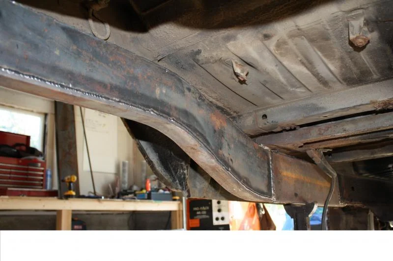

hey cam,
here is what i did for the rear of my bj60.. give me a shout when you got time
adam

Nice! Where did you get that bent channel? Ruff Stuff?? I like it. I started with the idea of just patching up the frame but now it has snowballed to something more permanent with upgrades all over. LOL. Oh well I'm cool with doing it once the right way.

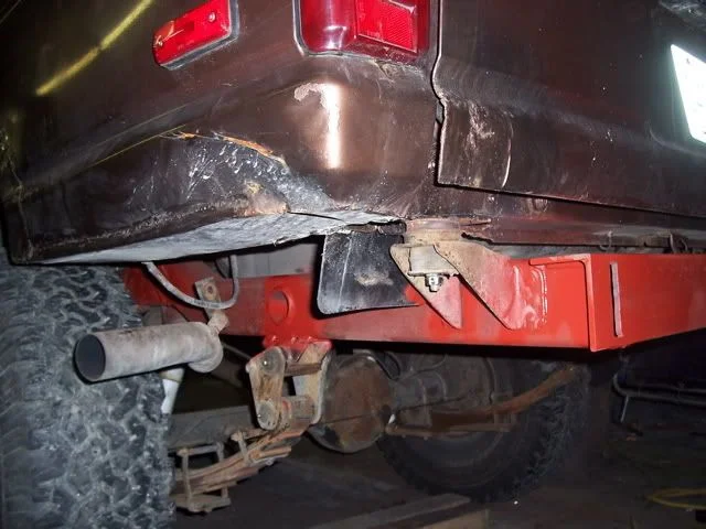

Well got one side mostly done and the other is .5 way. I need to rebuild some body mounts and install a 2" body lift as well. She's comming along slowly.

Thanks Adam. I made a posterboard template and then cut the steel with a torch. Its a slow process but I cut two of everything so the next side stuff is all cut. 2nd side will go much more quickly. Well i'm off to the garage to get filthy.
Cam
Did you do the outside of the frame too if so try an avoid vertical welds or use a diamond plate over the spot. Just info for ya. Did you build it in pieces ie top, bottom, sides.
Both the vertical inside welds are in factory locations where toyota did the same thing so i figured it was OK. Yes I also plated the outside and the bottom. I built it all piece by piece. I have more pics but seem to be having trouble posting more pics. seems my attachment folder is full. I tried using a url from photobucket but that didn't work either... WTF? ideas?

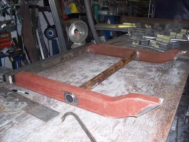

Here is the outside (avoided vertical welds) and the body mounts to replace the rusty ones fabed from 1/8 box tube.
Cam

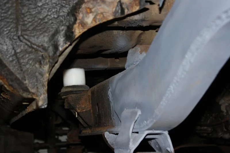

Installed a 2" body lift yesterday made from UHMD 2.5" and 2" cylinder stock. Now I have to lower the fan shroud and adress any shifter clearance issues assiotated with the lift. Having the body raised will help me mount the get the upper rear shock mounts as high as possible. Should make for better angles when building rock sliders as well. Next stage is axles.... then seats..... then a center consol of some sort.... will it ever end? lol,
Cam,
