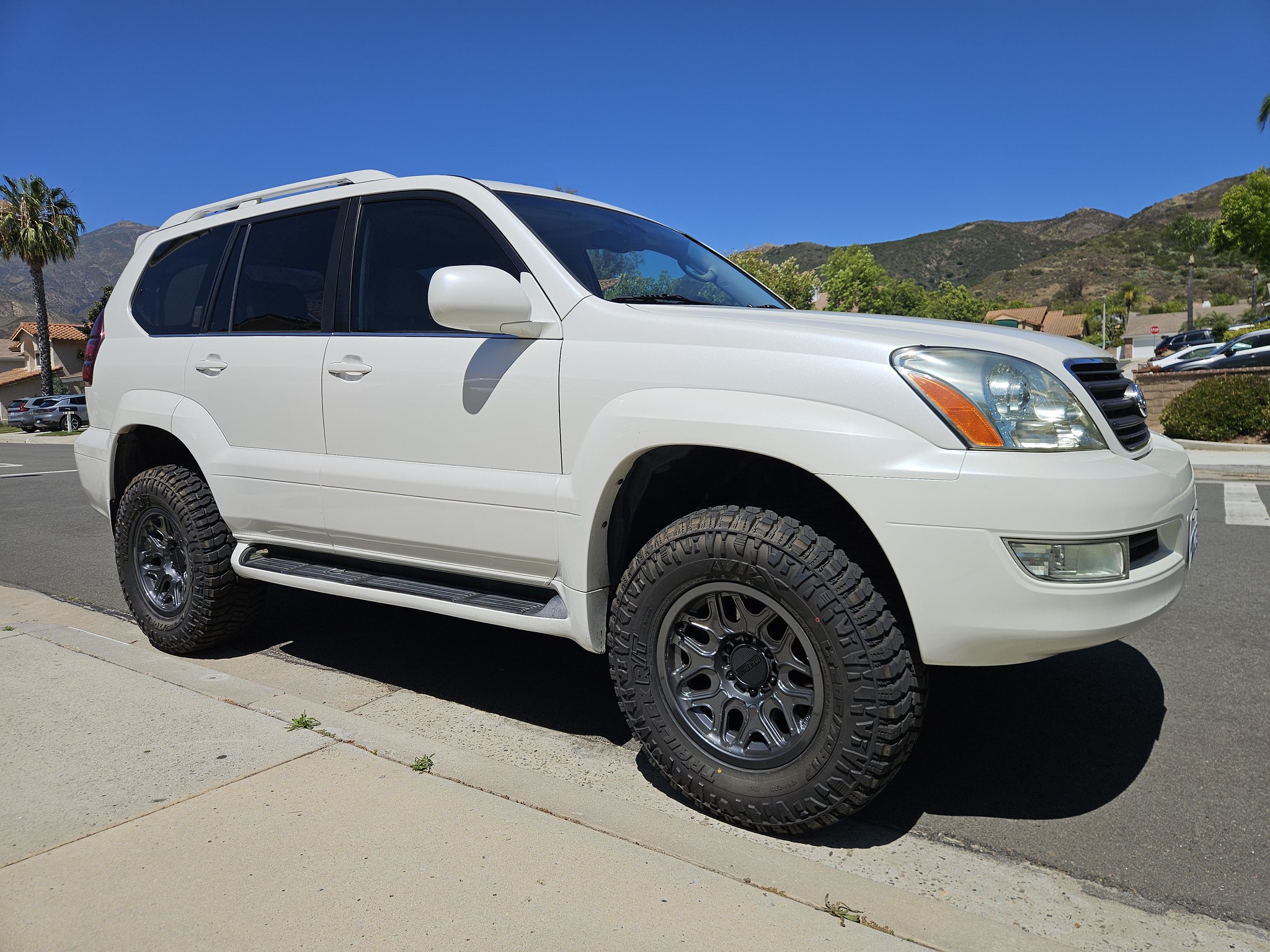

Got our new baby last week and found this forum doing a google search. she's a 2004 with 263k miles and change, pours like a kitten. Bought it for my son so we can all go wheeling with friends and family and i can drive my Jeep., He wanted a Toyota just like i wanted a Jeep when i was his age. Isn't that funny how the world spins
Anyways, the PO added a few goodies to this one , 5100's adjustable struts set on the 4th ring so from my search that is 2.5" lift ? and 5100 rear shocks along with OME 2889 springs, air bags deleted, 285/70/17 tires on Method MR322 wheels, I've added KSP UCA's cause the boots on the stockers were tored up, and while she was driving straight i could tell she needed a bit more caster for fwy driving, new front sway bar links, Torch front sway bar relocation spacers, today i'm getting some little longer links for the back just to restore the angle i think the rear swy bar should be. I had an 2010 FJC before so i'm doing things to this one based on that experience.
20260530_145350 by RAM RSM, on Flickr

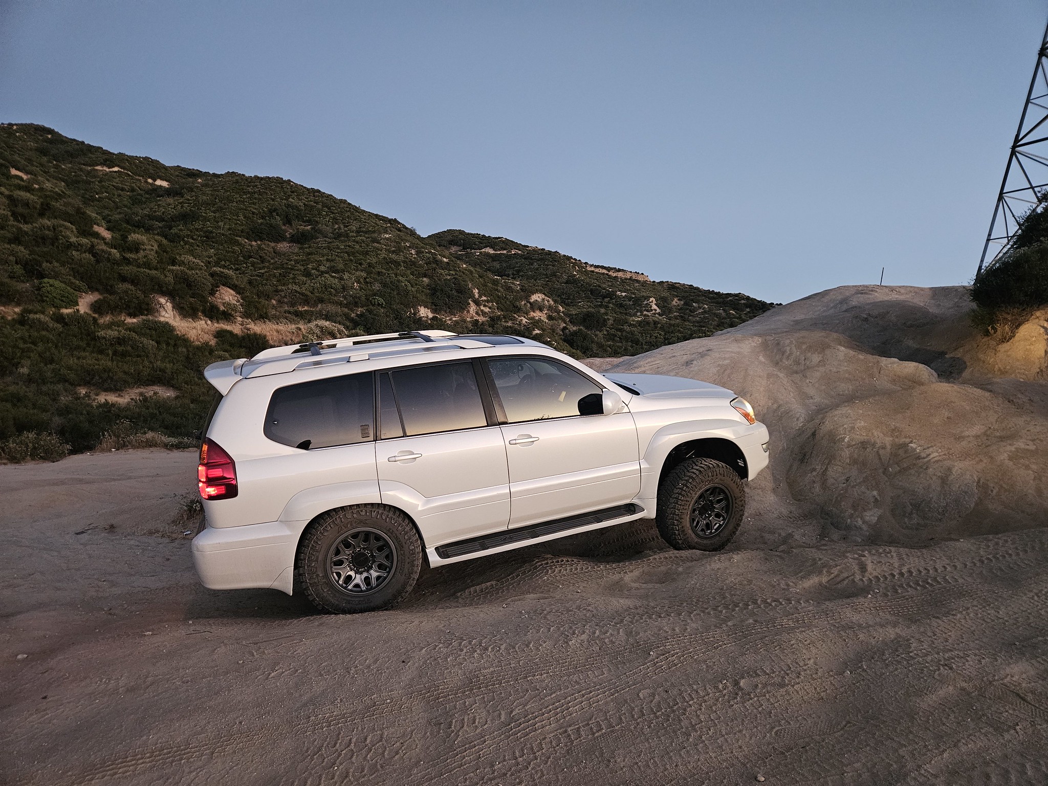

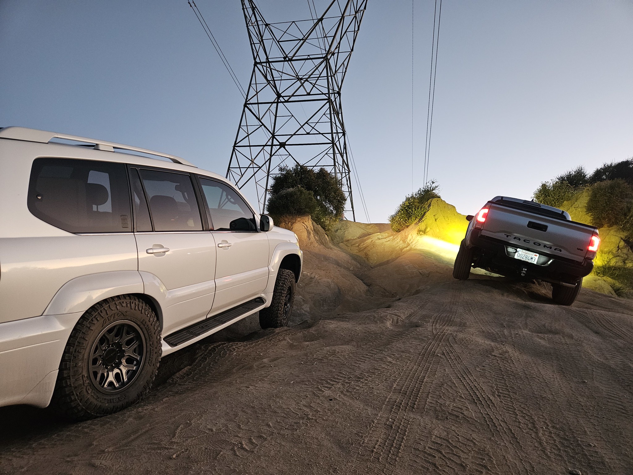

Testing ATRAC
20260605_202108 by RAM RSM, on Flickr
20260605_202054 by RAM RSM, on Flickr
