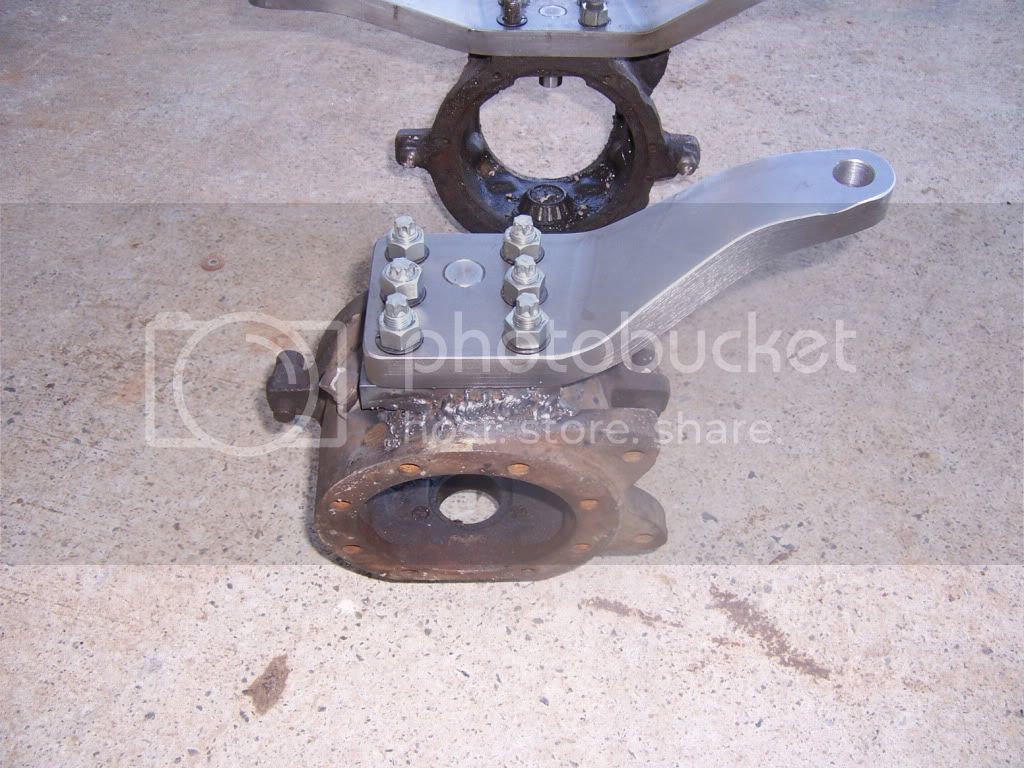

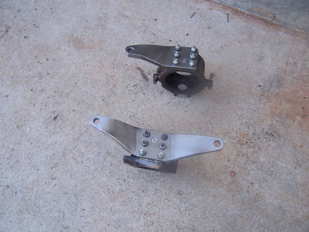

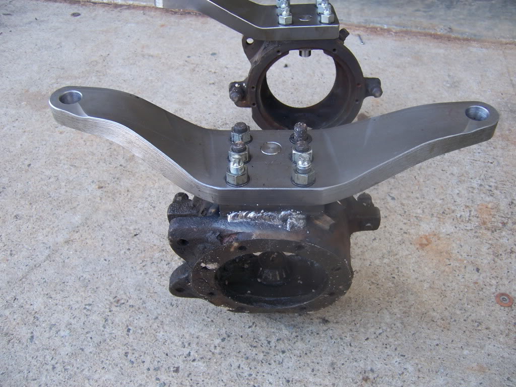

for anyone who was thinking of ordering a hi steer kit from 4x4 labs here is a picture of my kit. I went with the six stud kit and I like the end results. much more stout than stock. Now I just need to cut and turn before I can put it on.
These are the knuckles that im about to install on my 40 w/ my 6 stud 4x4 Labs Arms. TIG welded and I had the top surface Milled flat after the blocks were installed.
and YES 4x4 Labs parts are Super Nice.
....the knuckles are rusty because they are prepped for Powder Coating.
