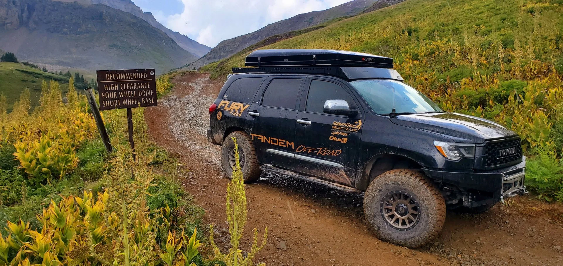

Is that a Platinum? If so, what have you done with the suspension/air bags? I have a Platinum myself and I never really have to off road it hard but I do spend quite a bit of time on gravel roads.
Yes, it is a platinum. I removed the airbags and swapped the rear lower control arms out with an SR5. This converts the rear from the airspring perch to the coil spring perch. You also need to get the rear spring isolator from the SR5. This is the coil spring conversion.

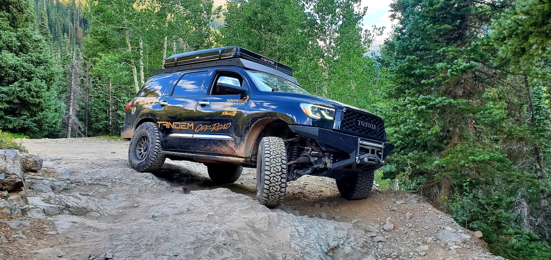

Congrats on the 19 platinum! What color interior? Have you seen the rear bumper on mine now?
Rigs like that are why I tell people I have the 'third most badass sequoia'. Though It is probably much farther back than that.
What awning is that? I cant get a good look. It looks short but fat. Is it a batwing style?
So you have any details (dimensions) on your rear bumper cut? If no one starts making a swing arm bumper soon I will cut mine.
Swing out rear bumper you say?
It is a 180 awning from 23 Zero. I really like the Alucab 270 but didn't want to limit my lift gates up travel, which it would have done.
