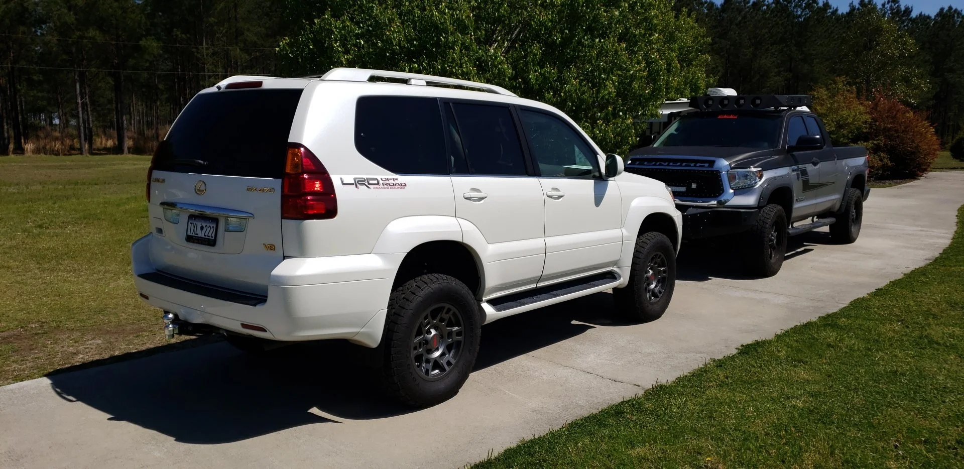

I didn't see this post. I bought the TRD Pro rims from Toyota parts warehouse in Orlando because I didn't want replicas. They are perfect! I put Toyo 265-70-17 on and they look great. They are a larger tire, the rims move out just past the edge of wheel well. Would recommend...

The TRD pro rims backspacing is such that it moves wheels out just past edge of wheel wells.
I really like them and of course quality is top notch. Order black lug nuts too.

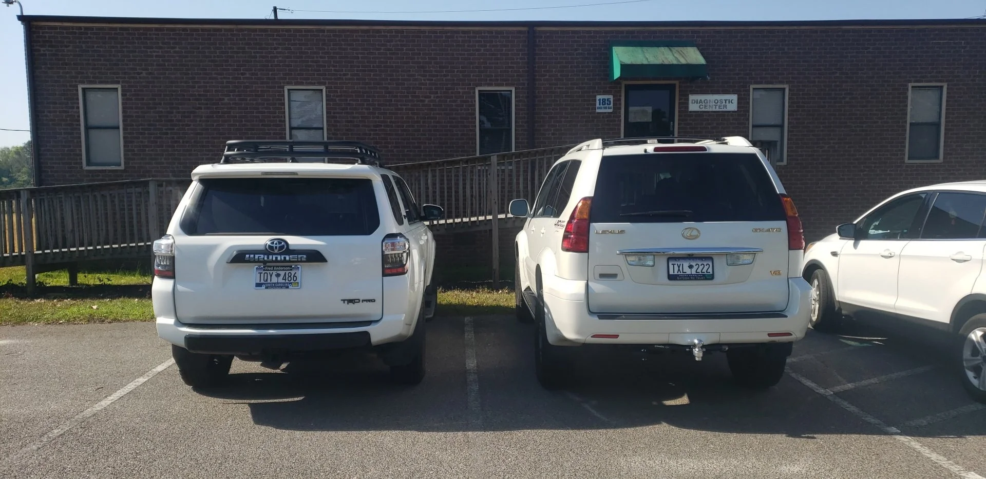

Toyota distributor in Winter Park Florida has best prices on rims. They list them on Ebay...see image, my GX is on right next to this 4Runner TRDPRO...
