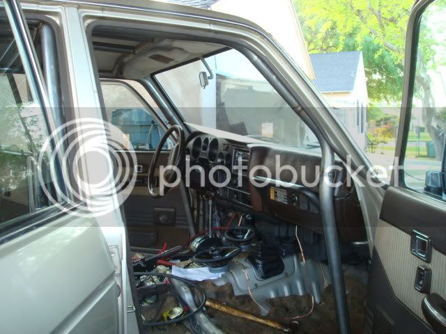

Thanks for the tip on the pictures. More pics to come as soon as I get the time. Today I will finish up by adding some tweeter mounts on the cage and painting it.

How much for a parts cage kit if I provide the material? I'd love to make a cage exactly like that but my bending skills are horrid. My truck will be very similar when finished, SOA, 35's locked F&R, but just stock engine. I'm jealous. :D
cage is looking good, I am guessing the drive train came out of a SSS or a Caddy.

Your cage is georgeous, very nice.
I imagine your amps hope you never set it over on that side:p

How did you get the cage so close to the roof without burning the headliner?
One more Mudder saying nice work! I've not seen too many internal cages on the board here; yours looks good!
I have the same Q that GLTH does, how'd you get it in there so close? (Perhaps I'll get the same answer he did!)
BTW, I'm a beige FJ62 guy, too!
The answer is to insert a piece of sheet metal and cardboard and use the mig welder, also clean the metal so it does not spark much. I designed the cage to be installer friendly, the tubes come a little taller so you cut to the size you choose, some may not be able to weld in a tight environment other may so I leave up to the installer to decide. Another method to get a clean look is to install the headliner over the cage, when you look up you see your headliner only and not the cage. This method requires you to re do the headliner but its very how do you say, cool. And thanks for the kind words. Plenty of friendly people here.
Nice work, I bet you have a lot of time in that! I would love to see a pic with the headliner installed under the cage.
Thanks. Takes about 36 hours to complete, that's including the removal of the whole interior (carpet, seats, panels etc.) regarding the headliner we'll have to wait for someone to install it that way.
