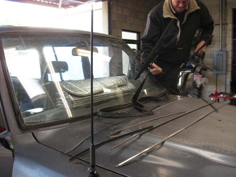

1- Old windshield (not OE)
2- Dirk cutting out old gasket
3- Da beast with her antenna up, shorn of gasket

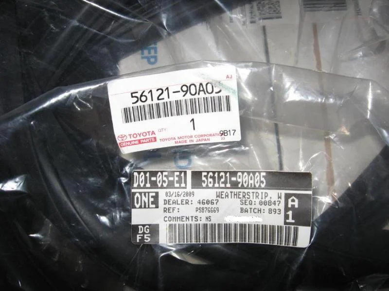

I asked Dirk to use the OE gasket I had already bought.

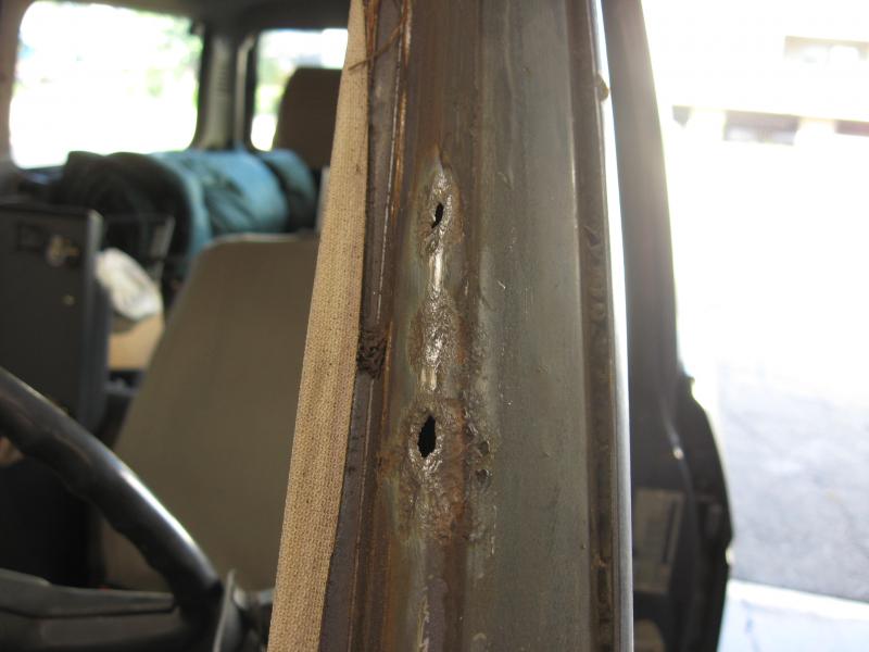

Shizzle ! Rust !!
1- Wire-wheeling rust spots.
2- !%!%$#@ RUST !! If I had been at home I would have welded the holes, but there was no welder at the shop... He said holes would be filled with urethane anyway, so...
3- Brushing on rust converter and some kind of encapsulator. He really took his time here and even let the stuff dry correctly.

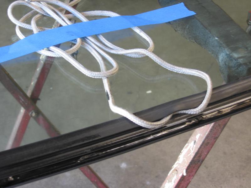

2- installing gasket.
3- Urethane on inner lip after roping the gasket.
1- Profile of locking strip... This strip was a GIANT PITA to install and Dirk said he'd never use it again. :D
2- Pulling the rope.
3- Centering the glass.

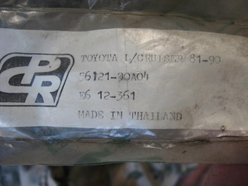

This is the part # for the aftermarket gasket as he had one in the shop.

The 56121-90A04 is the OE part # but it's been superceeded to 56121-90A05 as in the pic in post 2. I just went to the Precision Replacement Parts website (prp.com) and the new part # for the gasket without locking strip is WBL F425 . Your local glass shop can supply it.
