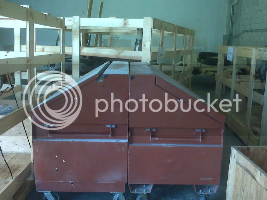

I purchased this M116A3 trailer some time ago and it is now time to start the build. I have a fairly unique idea for the box.the box will be made by joining two jobox sloped lid onsite storage boxes(60x30x37each). I picked the sloped lid jobox because since the camping lab tent 74x95 size will be ontop of the boxes supported by a tube structure, I will still be able to open the boxes and access from the sides. The tube structure that the tent will be mounted to will be welded to the boxes. This will make the entire box/tent structure removable via forklift, and I can store it in my warehouse when i have to use the trailer as a flat bed. All ideas and comments welcome. Let me know what you guys think.
the bed measures 96x74 inches
these are two jobox sloped lid construction site boxes I picked up cheap locally. the boxes measure L60xW30xH37. 300 dollars for both and they delivered it to my warehouse!
I cant wait to get the paint on these boxes. Dune Beige!!!

The boxes are nice, and really heavy duty, (and I'm sure heavy)but do really want to dig in the bottom of the boxes when you need stuff?

One more thing i decided on this morning. I was originally going to keep the feet on the boxes, but after some nifty work with my plasma cutter they are gone. this shaved 4 inches off the total height and I can now reach into them when on the trailer and reach the bottom.
I have also decided to line-X these boxes inside and out the same color as my truck, this should make them more quiet and tough. right now they echo like a dumpster when you toss something in them. Before I get them sprayed with bedliner I have to weld them together to make them one solid unit. more pics to come.
