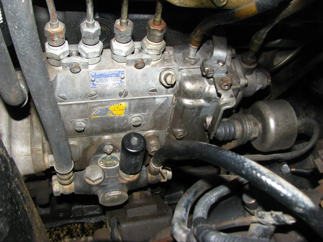

1) Do I need to rebuild the injection pump, (please see attached, is located all the way to the right position is that normal, I heard the mechanic do that to control the smoke emition but I have no Idea about it. Maybe I need to include a new diaphragm and some part between the engine and the injection pump, in Costa Rica Spanish, that engine part is known as "ciclo avance" the mechanic say is a part with two small weights that control the times I am no sure to understand that, anyway I ask already and I can get a good one (second hand or used) for only US$50. Besides that, does anyone know where to find a brand new diaphragm? In case I need to fix these parts and rebuilt the admit ion pump.

You dont necessarily have to rebuild the pump when you rebuild an engine but its good to have it bench tested and have the injectors rebuilt if the spray pattern is not perfect.
The "ciclo advance" is probably the automatic advance on the pump timing.

As for your injection pump, I take it you're saying that it has been twisted one way as far as it will go to try and control exhaust smoke and that your mechanic suspects the automatic advance/retard mechanism as being faulty.
I don't know about that. (They seem to be a very reliable component in general.)
Perhaps the timing cogs were not lined up correctly when your engine was last overhauled?
