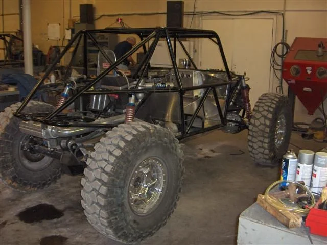

Progress is hard to see at this phase, especially since we have had it apart several times but heres a few to hold you over.
The Tin Men have been hard at work, and now the plumbers are banging it out.

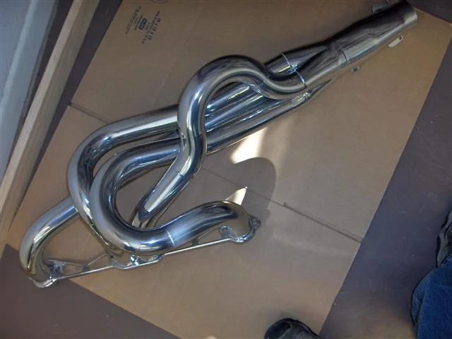

This is the how the front lowers tie in, that is the skid plate, highly polished I might add, just under it.
The last pic is nothing that goes on the buggy, just some beutifull headers we built that I just got back from the coater and felt was pic worthy.

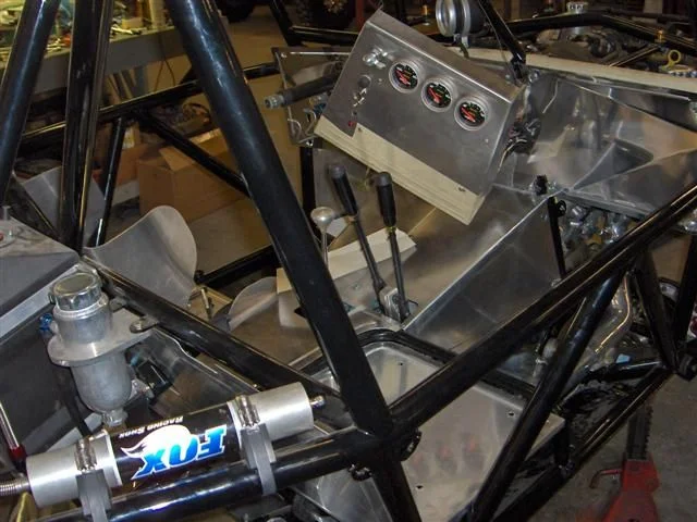

Was with it till late last night............added all fluids.............ran it and exercised some of the components..........trans, atlas, front and rear axles, steering, electrical.
Mounted aluminum top plates, mounted two tires and set all the bolts for all of the beadlocks.............over 150 of those fawkers.
Drivers side interior metal done!!!!!! Still like some passenger side interior metal :frown:
Custom front grill/bezal finished, duplicate of original, but cut down to scale.
Tremendous amount of plumbing in this rig......still underway.

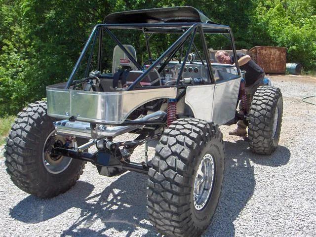

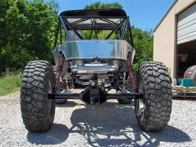

Well I have no buggy action pics (I was out taking my own last week) but I hear there was plenty to be had, here are a few of it as it sits today, DIRTY I might add, JIM. :mad:
LG
Not sure how that last pic got on there, but that one handsome dude, looks like hes spanking Rock Pile, AGAIN!
