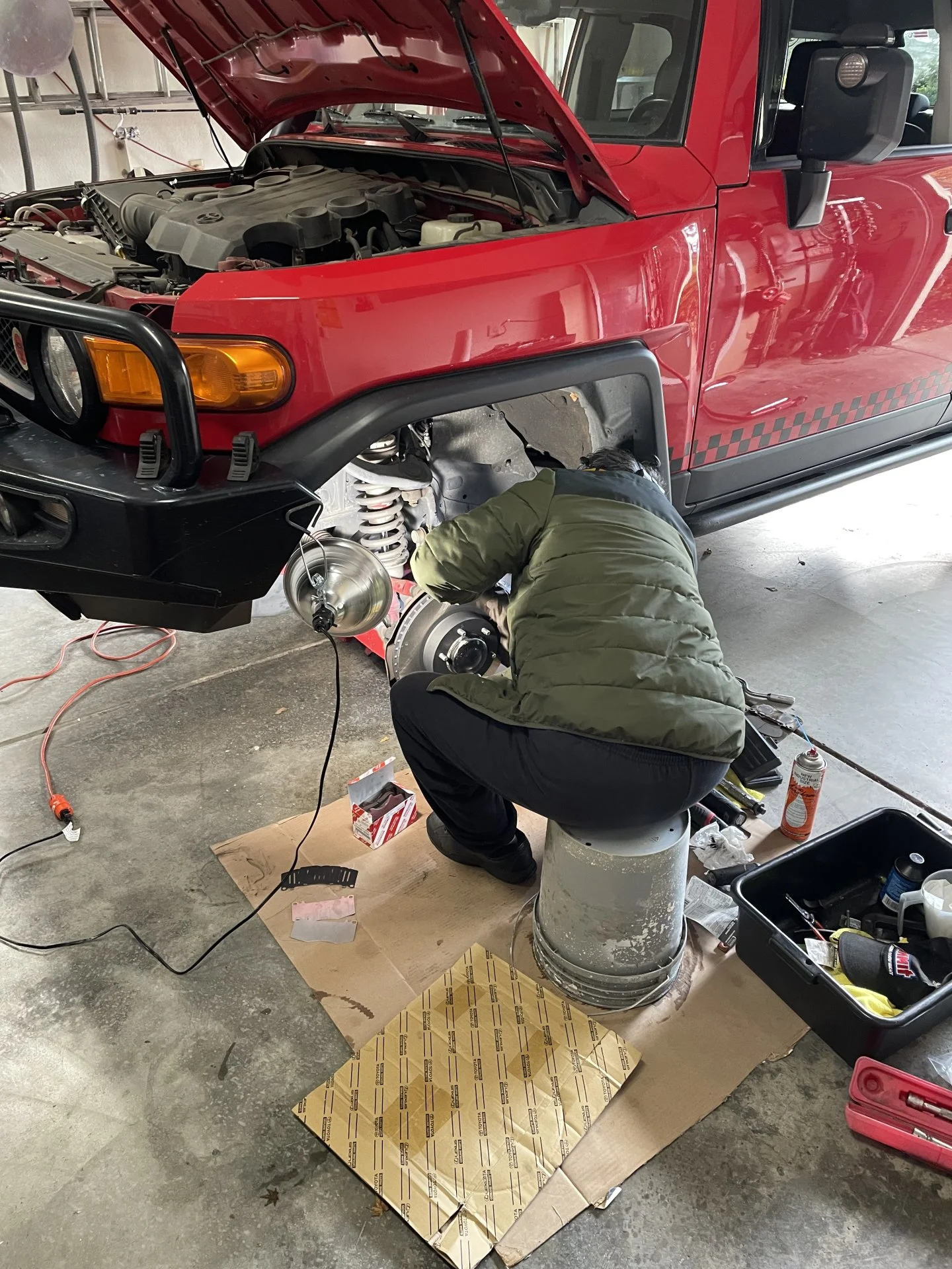

I just bought rotors and brake pads and all the anti-rattle shims and clips and springs for my 2012 TTSE. Took 3 1/2 un-rushed hours to replace at all 4 corners. Everything fitted perfectly. I have a complete parts list if anyone is interested. Cost $475 from a local Toyota dealer and I was charged $0 for shipping . My good friend Nestor helped with the work and I think it turned out fantastic.
