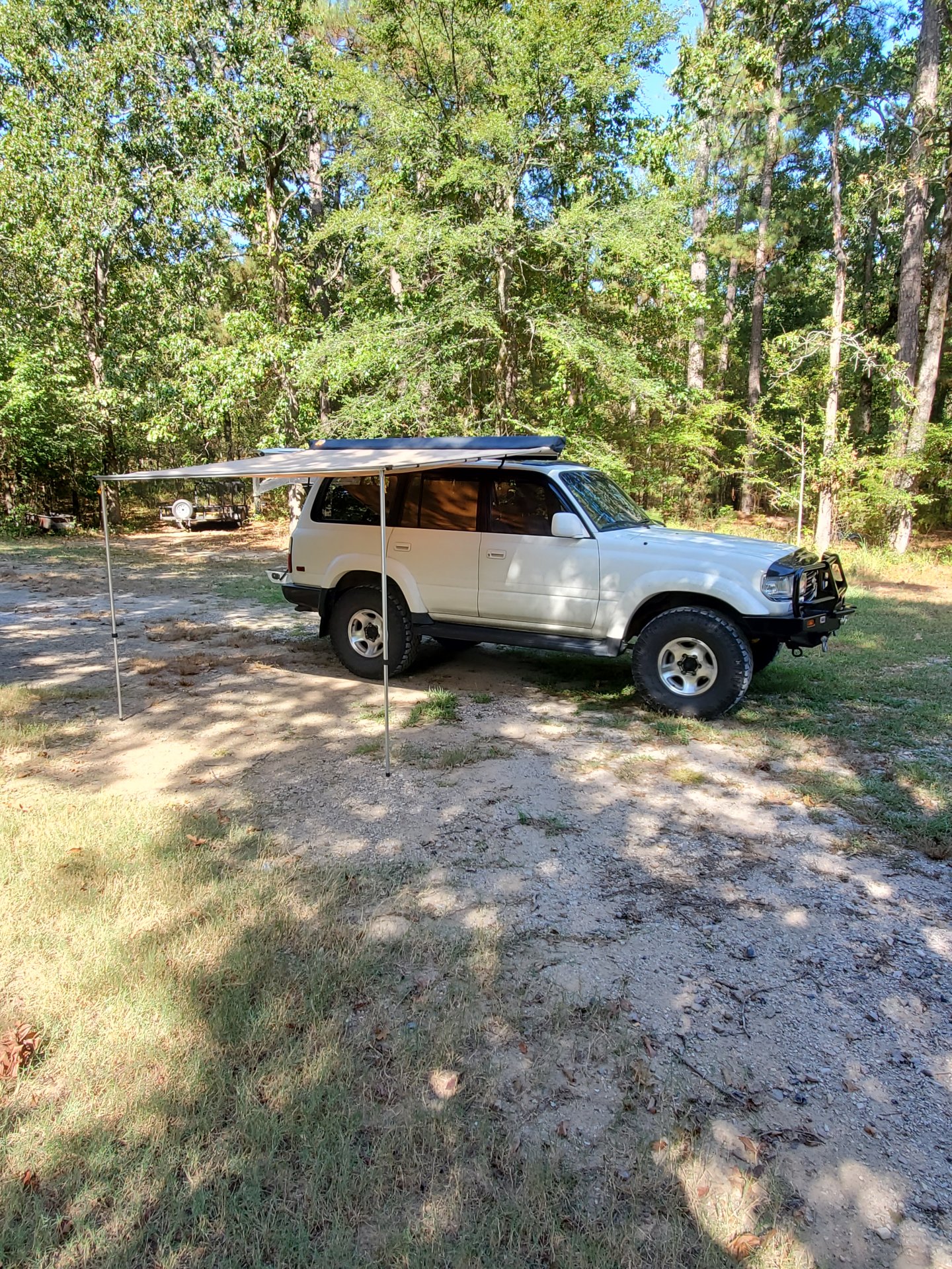

Was thinking about making the mounts as "quick-connects" so I can change sides for whatever the occasion. Thanks!!
Yeah, make it interchangeable between sides. Keep it versatile.
There’s a few different awning qr mounts that can give you the option to move side to side.

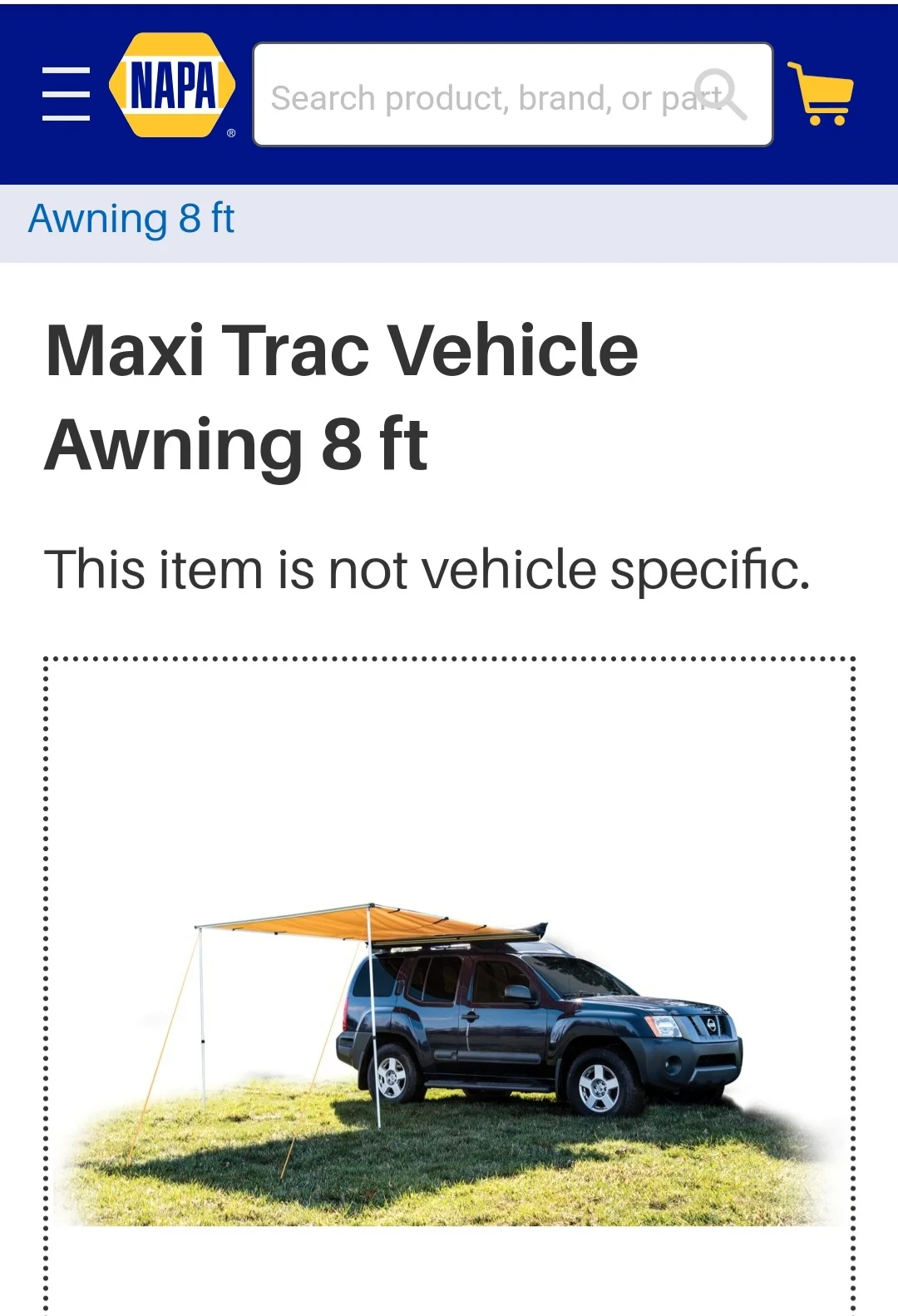

I don’t think the Ironman brackets match up to the Napa awning. I have one of these as well and was not able to easily make the already installed Ironman QR mounts work with the Napa awning. YMMV

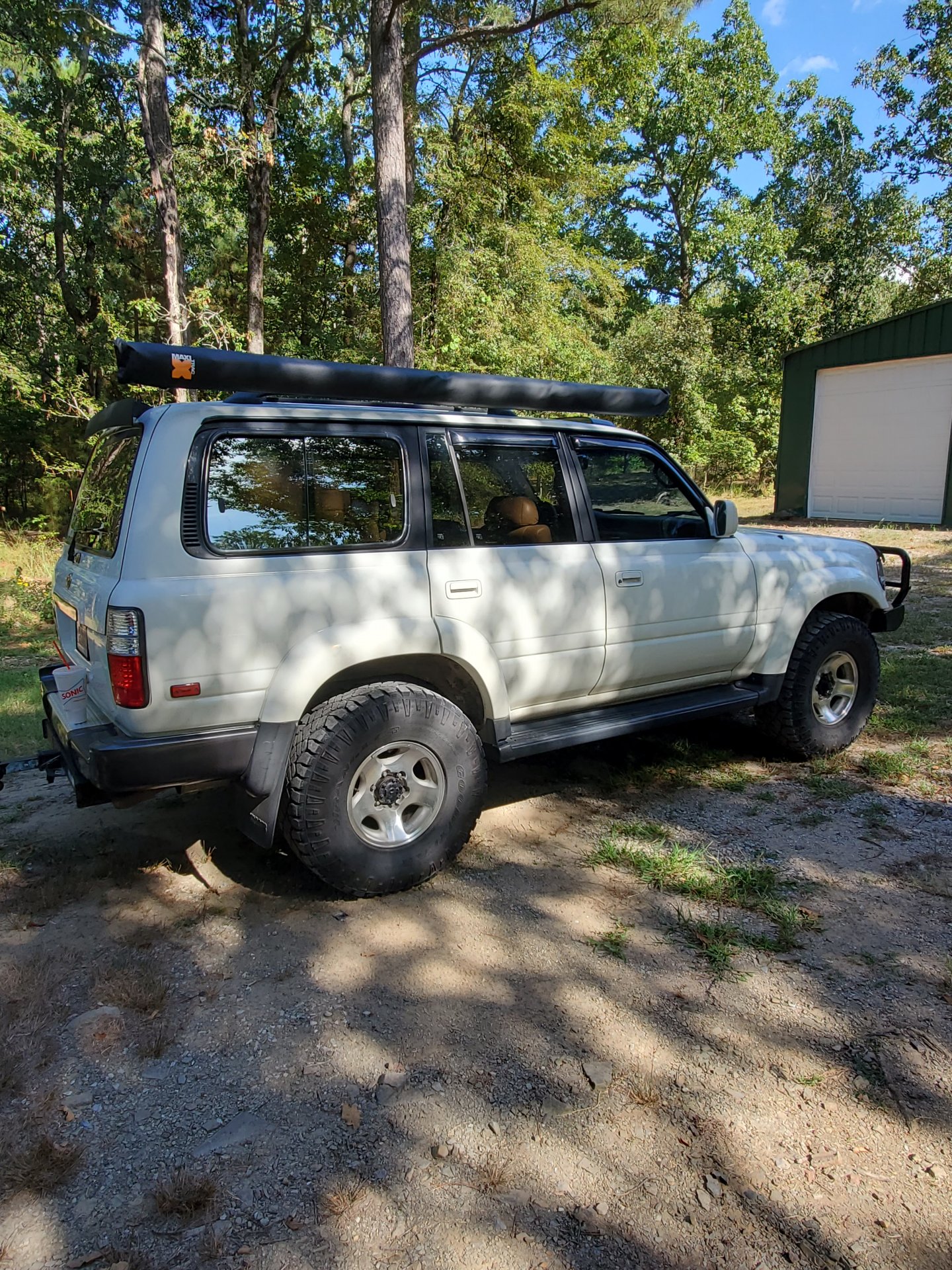

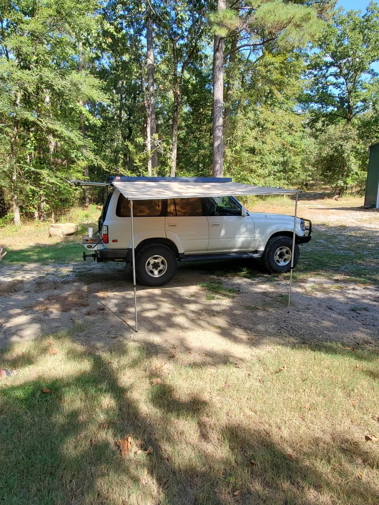

I just mounted it up to my factory rack. I drilled and used rivnuts. Ran the bolts through them so there are 2 pairs of bolts sticking up on each side now so it can switch sides by simply removing four nuts, then adjust for other side and tighten down. Worked out nice and the wife loves it! BONUS!! Hard to beat for $99.
Buy two. One for each side......
