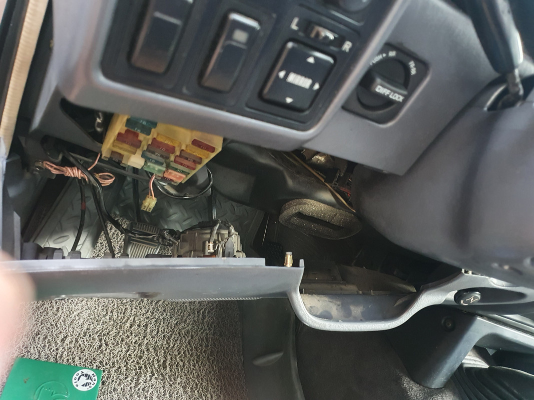

For the two on either side of the gauge cluster you remove 4 or 5 screws in the lower panel and it comes off and can just hang there. Then six clips are holding the middle panel in place. Then a couple screws and a couple clips hold the upper panel in place. When you pull that upper panel out the vents are attached to it. Easy out with the old and in with the new. I don't know how big this picture is going to be so I marked the screws red and hilited the clips yellow. The trick is knowing where the clips are. You don't need to remove steering wheel, etc...

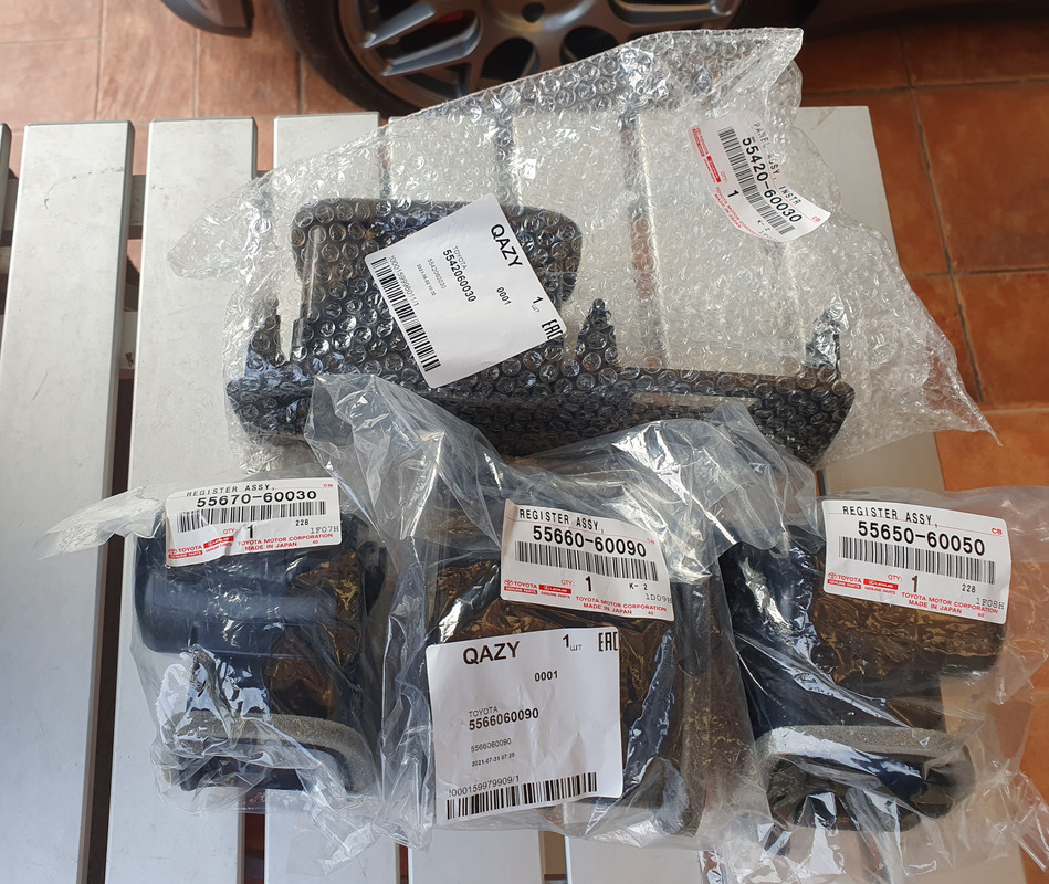

PNs & Prices off Amayama:
Dash AC Vents/Registers
Part Number & Description:
55420-60030 - Panel Assy, Instrument Cluster Finish, Center - $41.91
55650-60050 - Register Assy, Instrument Panel, NO.1 - $45.08
55660-60090 - Register Assy, Instrument Panel, NO.2 - $29.39
55670-60030 - Register Assy, Instrument Panel, NO.3 - $31.19

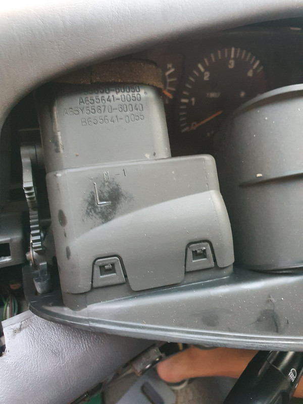

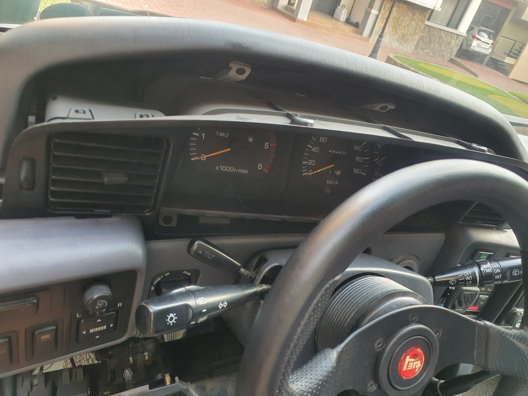

1. Driver side: 2 vents by the instrument panel:
-Just followed the post by @96FZJ80 above to remove the panel below & around the steering wheel, which I also took off to clean 25years of dust off.😊

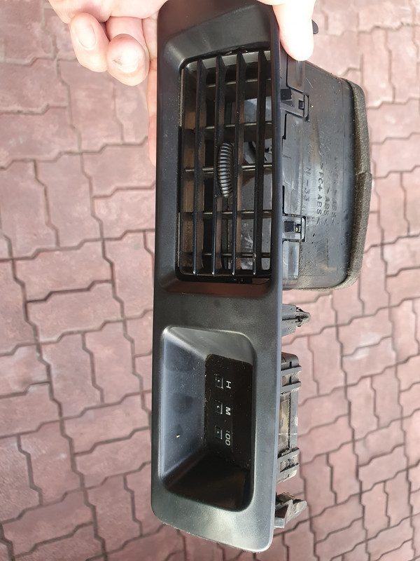

2. Center vent w/ clock assembly was simply held by clips. After step1 above, found some access to push the center vent from the rear & pull the assembly off. Unplugged & Unscrewed the clock, then transferred that to the new 1.
3. The passenger side vent assembly was the toughest to remove. 2 top tabs were sharp & hard, causing so much resistance to pry out. In the end, decided to just break that assembly to pieces than risk scarring the dash skin. The new 1 went in easy...press in & the 2 big hard tabs above & 2 soft lil ones will just lock in place.

Anyone know where you can find just the ac vent itself without purchasing the whole clock bezel / center assembly for the AC vent , my ac vent cracked but everything else is in good shape, has anyone had any luck with other vehicles or Dorman parts ?
