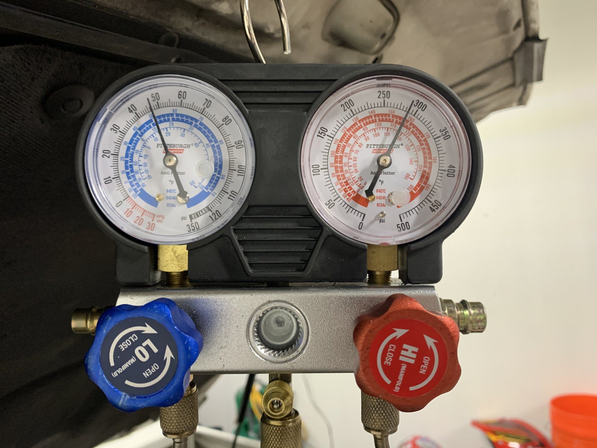

Got everything back together. New o-rings all around. Added exactly 2 bottles of refrigerant and here’s the pressures I’m getting

According to the ambient temp, your pressures are just outside the normal range, Low is a touch low and High is a touch high.
You need to get a vent temp, it should be around 25 to 30 degrees less than ambient, got a cooking thermometer?

Your readings look exactly like mine does. After the initial repair, I took it all apart twice looking for a blockage I could never find. Put it back together with a new TXV and drier/receiver and its running about like yours.
If the vent temp checks out, I'd be tempted to leave it well enough alone.

His pressures look like he's at idle and about 95 ambient.

Low gauge will sit in the 20's, high gauge @95 degrees will be around 300 psi, Vent temp should be around high 30's-low 40's degrees. Your high gauge will go up and down as your fan clutch turns on and off.
Your Low gauge pressure is what your evap temp is (not vent temp). If its too low it freezes and a safety switch will "cycle" (turn on and off) your compressor. This pressure is controlled by your TXV
Your High gauge is your condenser and radiator fan. How much heat is being removed. If the high gauge goes over 450-500, a safety switch will cycle the compressor to keep it from being damaged. This pressure is controlled by fan/condenser.
Normal pressure readings @ 1200 - 1500 rpms, fan on high.
Low Gauge 20psi - 30psi. Over 35psi (at speed) can mean a stuck open TXV or compressor valve issue.
High Gauge is based on ambient temp. Basic formula is Ambient X 2.45 (min) Ambiant X 2.5 + 50 (max). 100 degree ambient = 245 - 300 psi. Humidity will effect it. high humidity will raise the range and low will drop a little.
