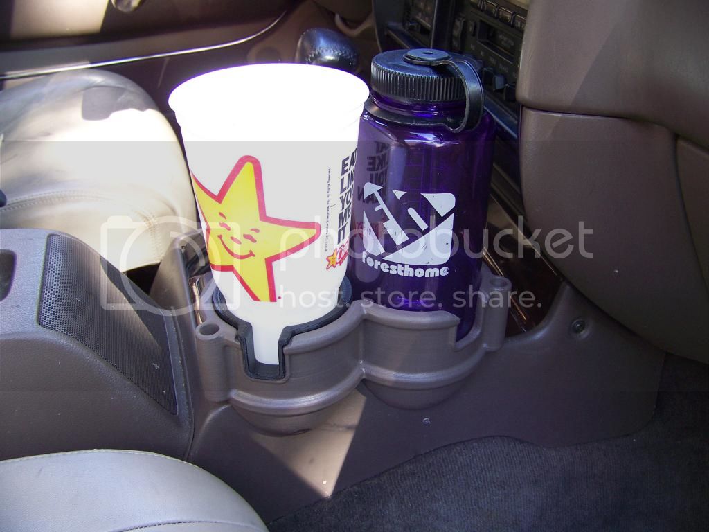

What size water bottles will these fit? The Mrs and I both have 1 liter Camelbak Eddy's. Naturally, they don't fit in any of the cup holders or the pocket in the console. I've lost my water bottle a couple times to the floor and have to wait for a right turn to grab it.
I know it holds the Nalgene bottles. Do you know if it is bigger then one of those? Here is a pic of the Nalgene bottle. The black insert has to be removed to fit the bottle and it's a tight fit but it does fit. I made the cup holder specifically that inner diameter so it would fit the Nalgene bottle.
I don't have a Nalgene water bottle, so I decided to measure. Then I couldn't find the tape measure (the kind used for clothing and sewing) so I used the string and metal tape measure. I got 11 1/2" circumference of the water bottle at the base. Based on what I could find, that 32 oz. Nalgene bottle comes out to around 12" using the string and tape...so I think I should be good.
Sounds like it should work. I do have a couple in stock. I was sold out for a couple days but got a couple printed up yesterday and today.
I received my double cup holder on Friday and got it unboxed today ( I left just after mail drop on Friday for a weekend on the river). I love it. Thank you for taking the time to make these. I just used the tape to stick it on for right now. Anyone have catastrophic failure (yet) from just using the sticky tape without screws? Trying to get a good guess as to tape's failure point. Looking forward to more designs for various things from you!
I wish I could say if the tape alone will hold indefinately but I just don't know. I installled mine with the tape and 1 screw. I had a leftover hole from the old "disco" cupholder and I used that on one of the lower holes along the passenger side. One screws and just the tape has held up great. I have done heavy wheeling with dual nalgene bottles filed to the top and nothing has come loose yet. I planned to use all 4 screws holes but just never got around to it.
