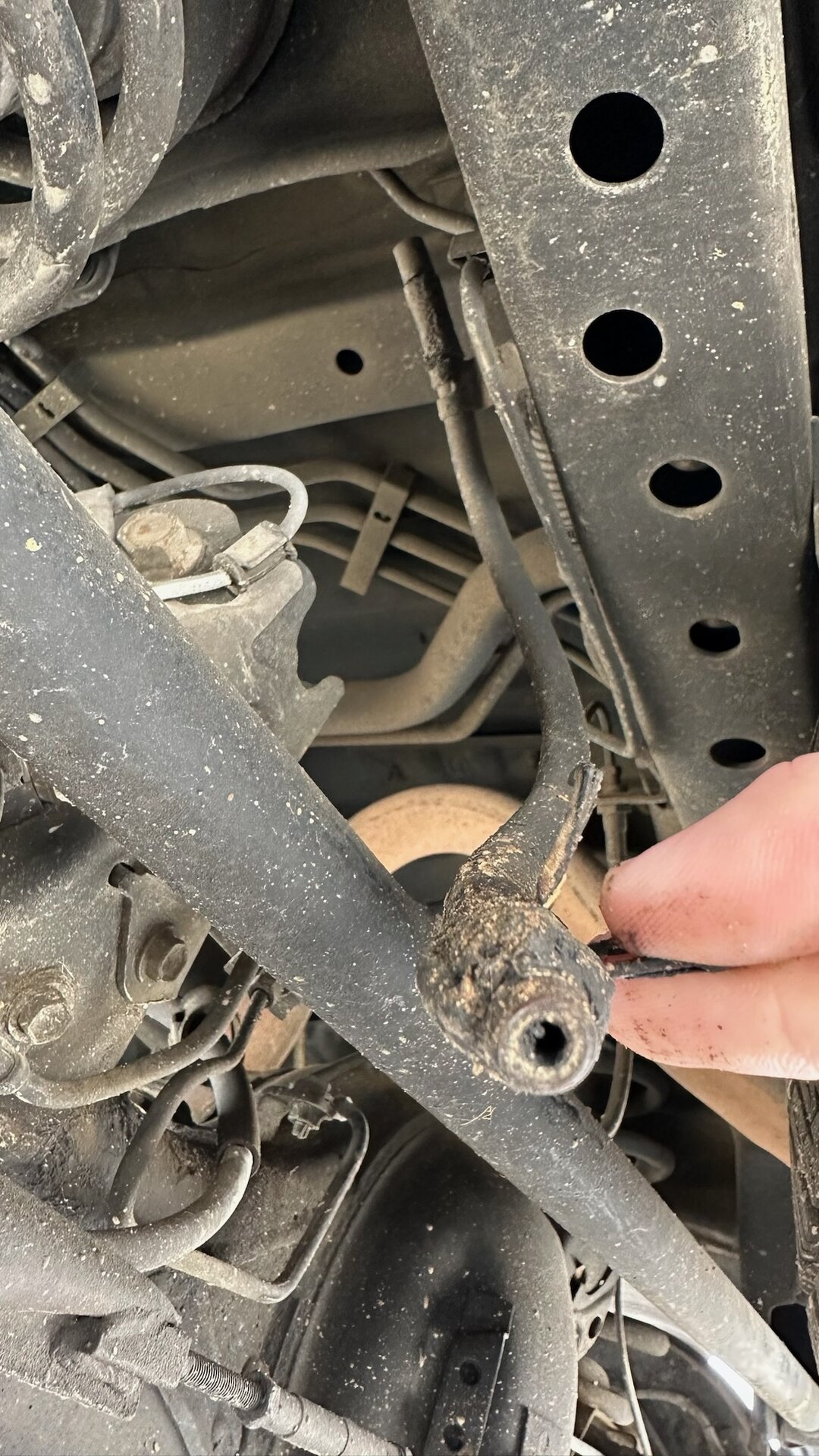

Anyone know what this goes to? I am assuming it was leftover from the previous owner removing the AHC.
Looks like a breather tube. Hard to tell from the picture, but I think it's for your rear differential and should be connected to a little nipple on top. You will want to clean it out before reconnecting it.
Correct that’s the rear differential housing breather. The one-way valve cap on the other end of that tube is the giveaway.
