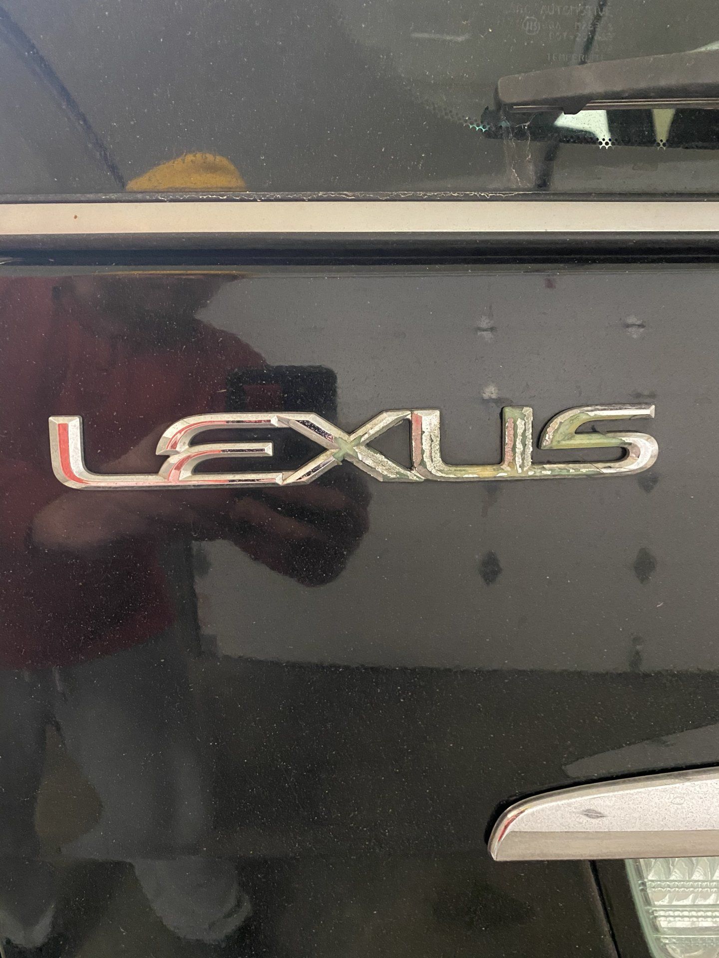

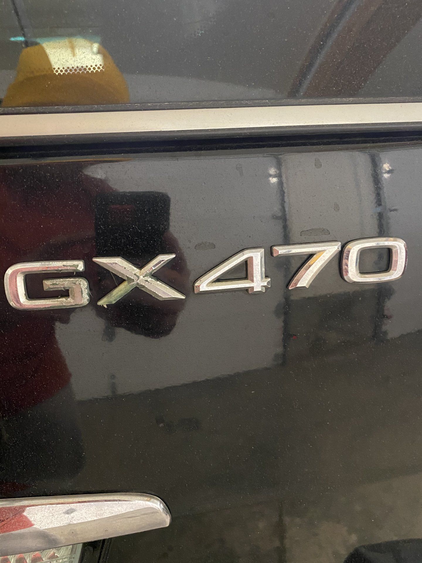

My emblems in the book look a bit odd with some blue stuff. Can I replace these? Will it mess up the paint? How hard of a fix is it?

Hit the emblems with a hair dryer and peel them off, then clean the residue with GooGone or WD40, followed by soap.

So the emblems are just held on by some type of adhesive then?

Yes, the emblems are just taped on...larger ones like the big "F150" on my old truck had holes underneath with alignment pins on the emblem itself, but these thin lettered emblems are pretty much all just stuck on.

Got it done and turned out better than expected.
