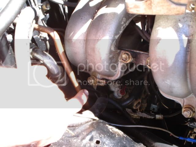

you should check this grounding bolt.
If loose can cause no or poor idling. and misdiagnosis of sensors.
furthermore, the EFI wiring harness may have poor ground splices.
Also, You should check the ohm specs on the TPS and AFM.

Found the problems. A broken wire coming from the Distributor and a bad ground were Wrist Pin said it would be. The shop wanted to argue until i handed them a print out of this post. He checked it and cleaned it and the third remaing error code went away.
