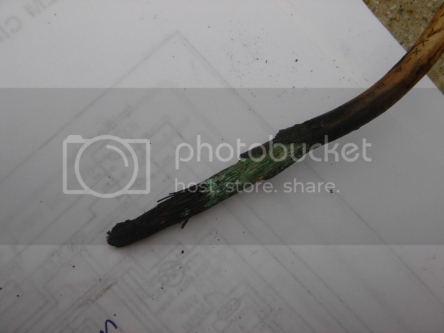

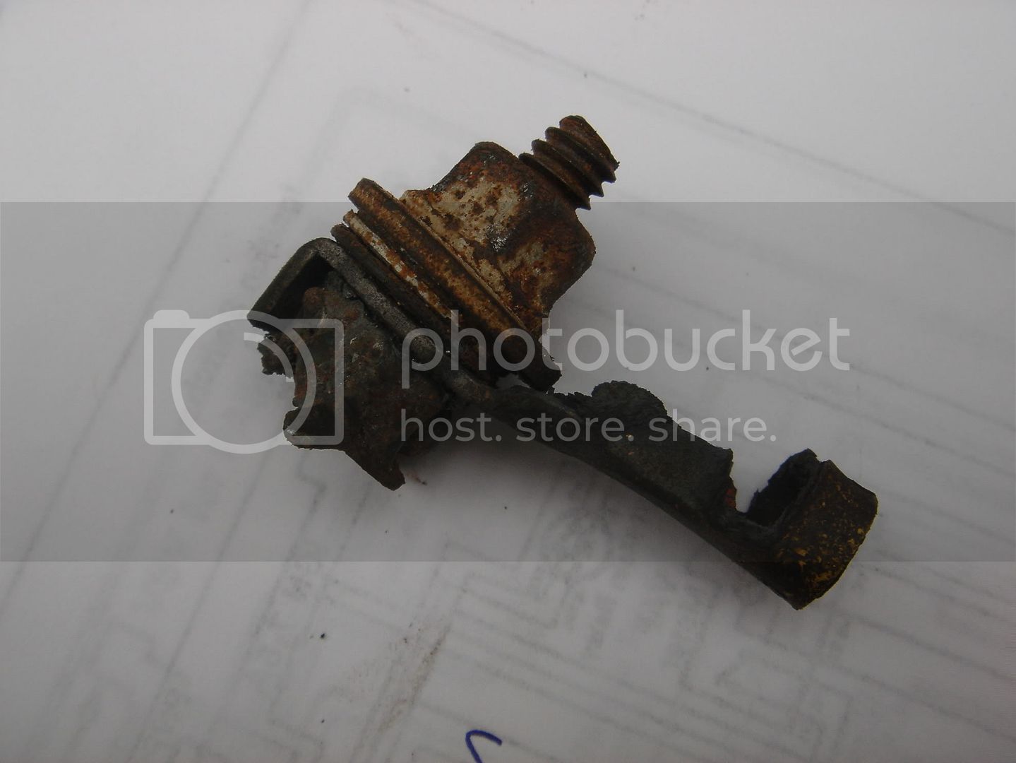

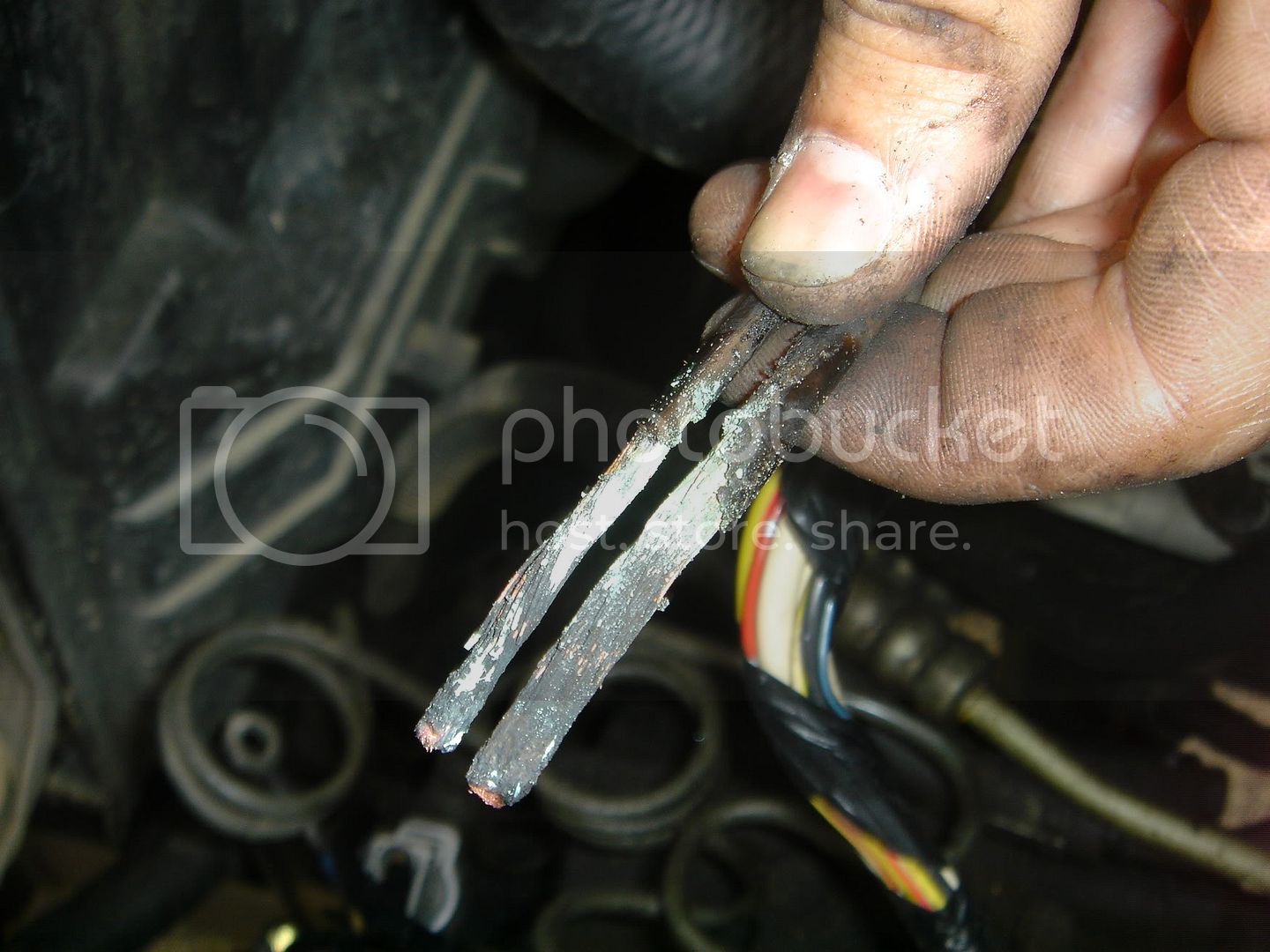

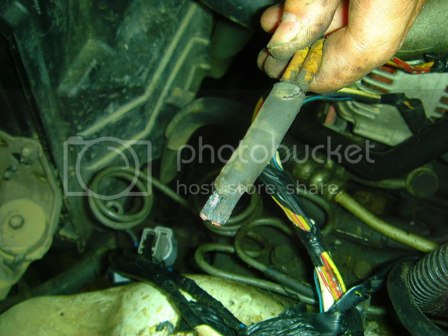

So I got up bright and early at 5:30am this morning so I could meet my friend at 7 to start working on finding the electrical gremlin that has had my Cruiser parked for the last few weeks. He's an electrical engineer, so I had confidence we could find the problem. We dug in, following the FSM and our hunches till we got it isolated to a short somewhere between the Main Fusible Link and the 15A EFI fuse in the underhood fuse box. Took us maybe 2-2.5 hours to get to that point. Mainly what held us up was that I had wrongly assumed that the fusible link by itself was the Main Fusible Link. Wrong! Its the one with the largest gauge wire that goes into the tinybox with the other fusible link.
Up till we figured that little mistake out, we couldn't make heads or tales of what was going on.
