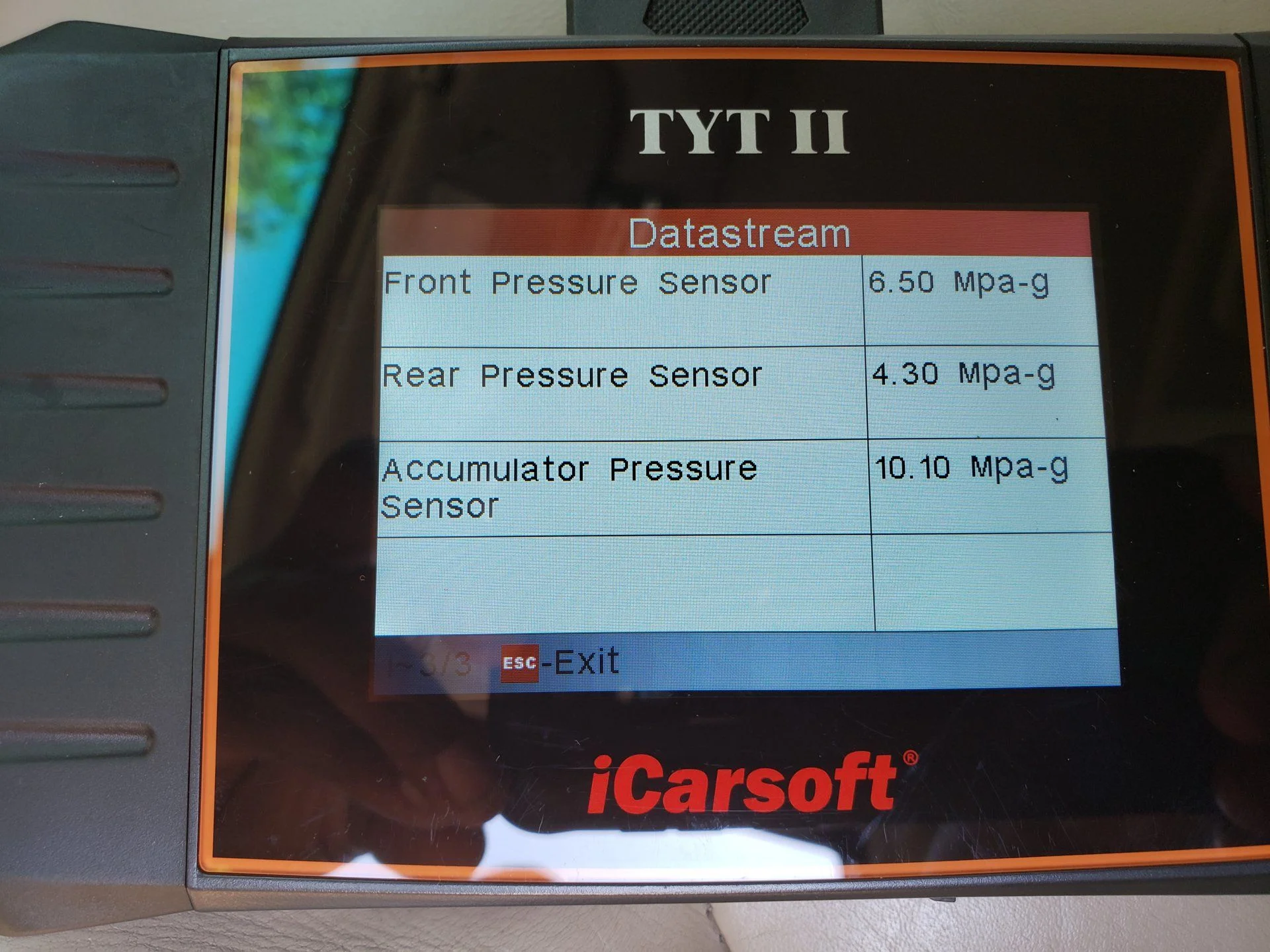

Just install mine last week on my 05 LX with 157k. Ride is 100 times better. Changed along with sway bar links and bushings. Feels like a new vehicle. How do I get the rears up alittle more for spec?
How you like them? I'm mad it took me so long to install them. Did you adjust the front sensors? I didn't. Some say you have to but I'm back in spec after cranking the torsion bars alittle and sliding the rear sensor up.
I love them. It rides much better. I didn't have to adjust the front sensors since the left and right height are the same and the techstream show 0.1 inch delta.
