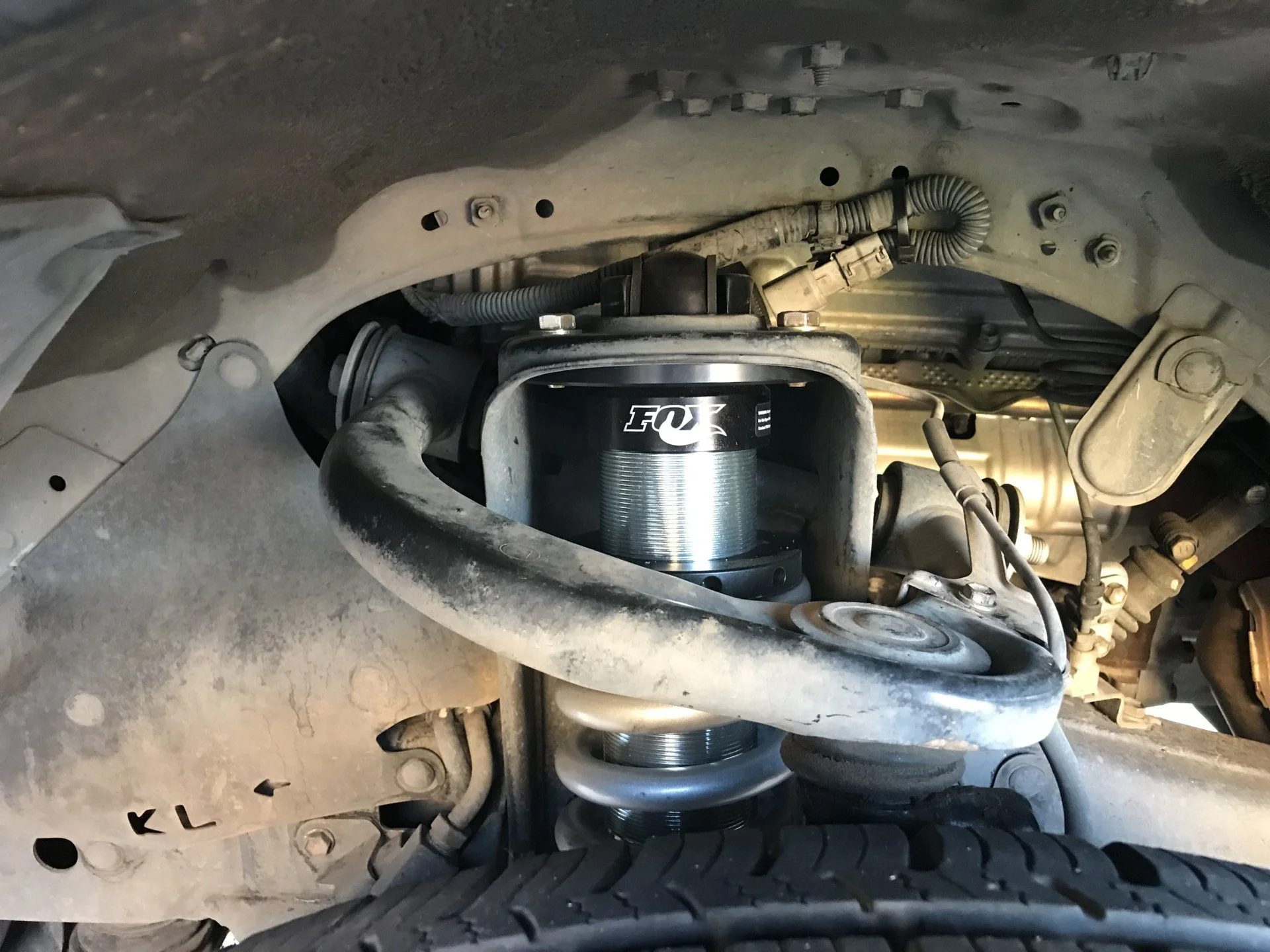

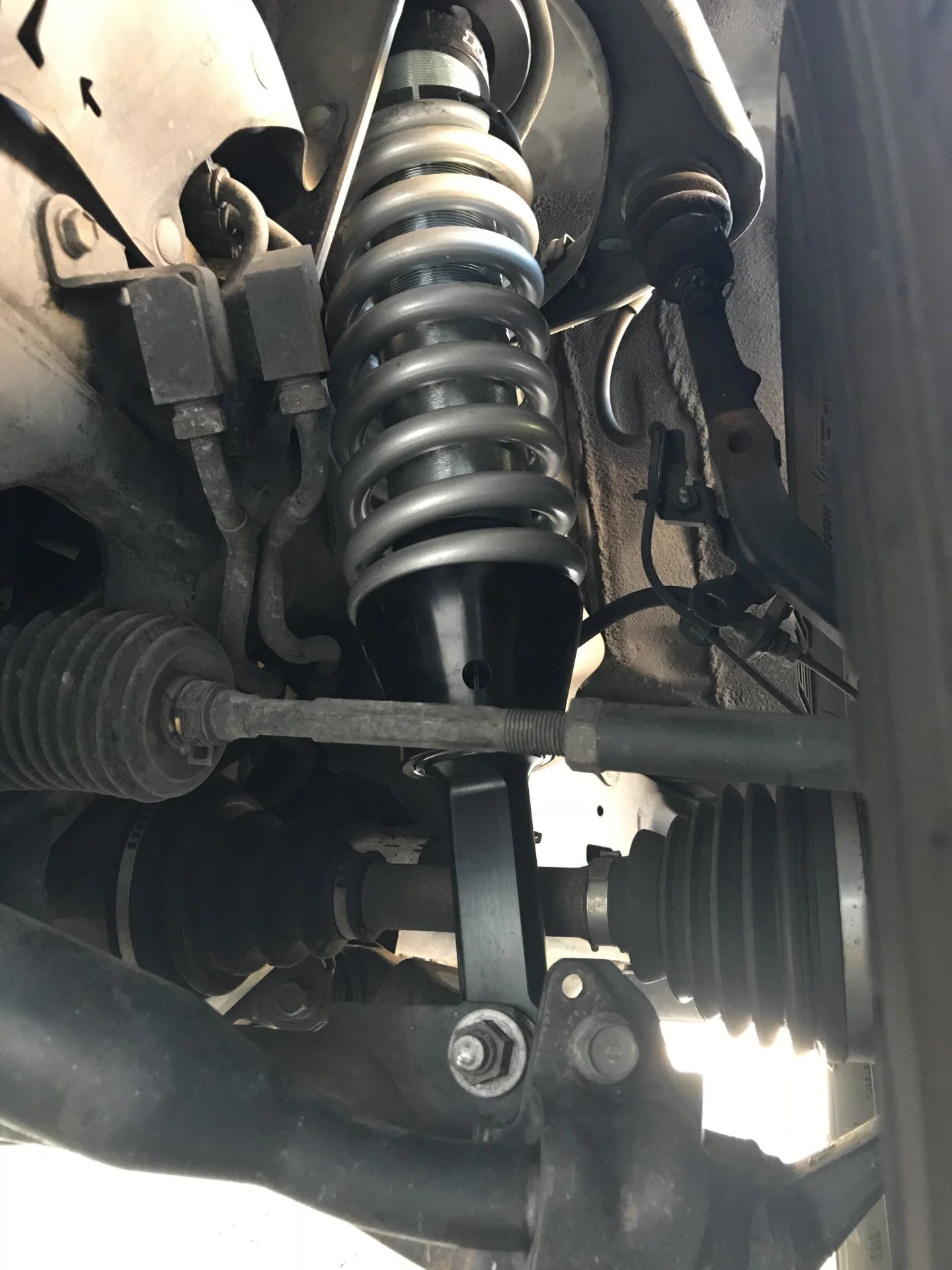

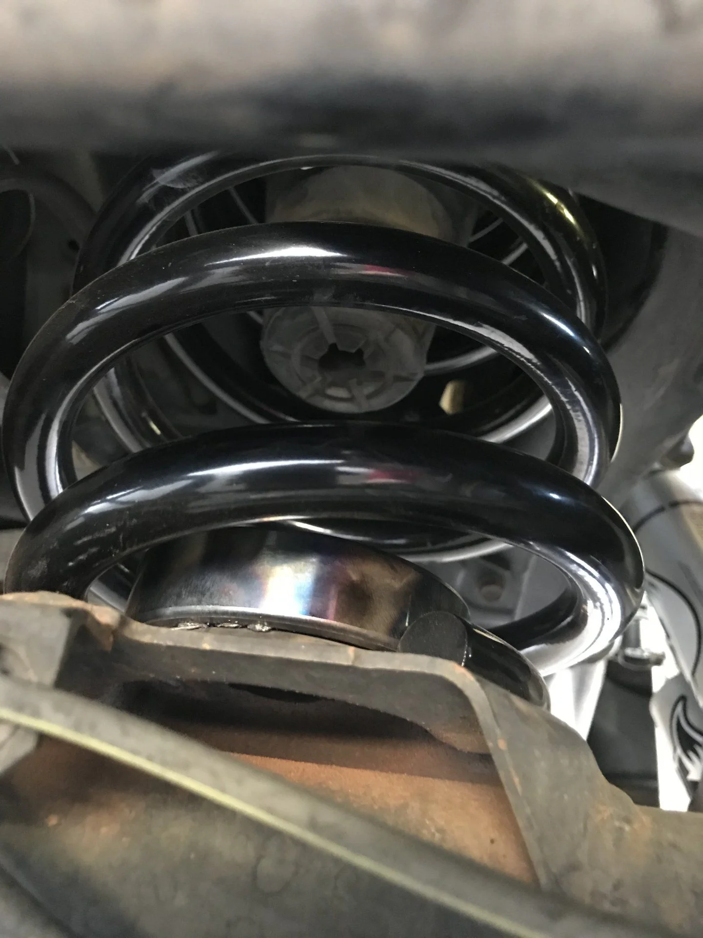

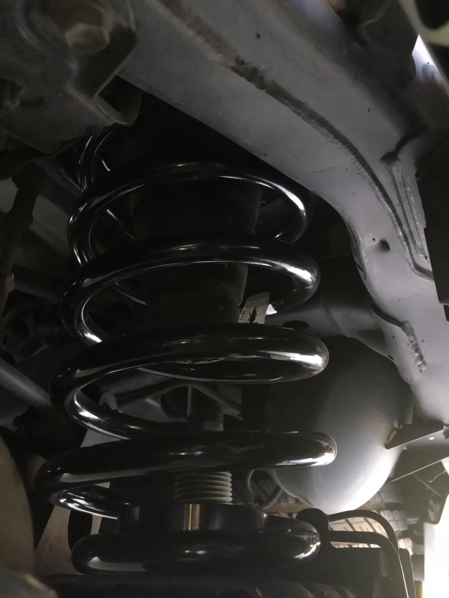

I just changed out my airbags for springs and shocks. Ride is GREAT. I did not want much of a lift. Will and his team at Sierra Expeditions nailed it. Here's the list of parts. Ride is still very smooth like the air suspension. My GX does have KDSS. If yours does not, perhaps the handling may vary a bit.
OME 2895e rear springs (for Prado short wheel base)
Fox 2.0 Remote Resi rear shocks (03-09 4Runner/07-14 FJ Cruiser)
Fox 2.5 Coilovers (Toyota 120)
The cost with labor and alignment was $2,600.

@Dclain87 swapping out the rear yourself is not at all difficult, and only requires basic tools: jack, stands, 17mm and/or 19mm (ratcheting wrench for top shock mount is super helpful). 14mm for swaybar endlinks iirc.
Even with very basic mechanical skills and a dose of common sense and good eye for safety, this is easily doable alone. I didn't use a spring compressor on mine nor did I loosen panhard or control arms: you can use the factory bottle jack between frame and axle to get room for springs, or (as I did) have a lovely helper stand on the axle.
It really is easily done at home, read some of the threads here about which fuses to pull and you'll be all set.
