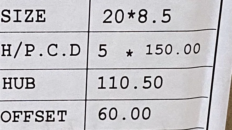

I’ll be using aftermarket 20x8.5 with offset of 60. Here’s a picture with specs

That should be OK.
