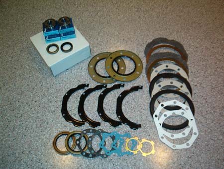

Check this link if you have not already...
http://www.sleeoffroad.com/newbie/newbie100.htm
One more thing, found this online:
http://www.cruiseroutfitters.com/lock_FA9097.html
Knuckle Rebuild Kits - FJ80 - Sale Price $115.00
Toyota solid front axle knuckle rebuild kits, one required per axle. Includes seals, gaskets, shims and Koyo trunnion/knuckle bearings. One required per vehicle.
(Fits 90'-97' FJ/FZJ80 & LX450)
Part# FA9097

Knuckles are humming when I turn now, so I definitely will be needing that kit, thanks for the heads up fjc8871.
