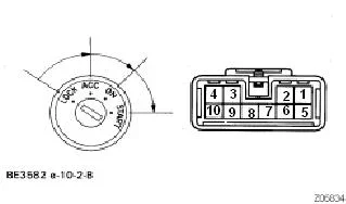

Thanks 40Habits - I am a total rookie on repairs. I ran 12 v directly to the S terminal on the solenoid and it cranked. I am not sure I am checking the solenoid correctly. I ran the positive to the S2 terminal and the negative to the negative terminal on the battery - no current 0.00. One of the procedures I read says this shows a bad ignition switch or a bad neutral safety switch. Kinda lost here.
I would check the ignition switch next.
Switch position
LOCK − No continuity
ACC 7 − 9 Continuity
ON 3 − 4, 6 − 7 − 9 Continuity
START 2 − 3 − 4 , 6 − 9 − 10 Continuity
OK - After I checked the fusible link wires from the battery and the ground from the battery and the solenoid, I checked the ignition. Everything checks out except the 6-7-9 with the key in the on position. I also looked at the neutral safety switch and it appears to be OK - no corrosion or anything obvious visually. So - a new ignition cylinder? Or is there some work around for this to make sure it is the problem? 2 days ago, I tried turning the key to start about 20 times and a few times it started to move and once it cranked for a second. The solenoid clicks every time I turn the start key. It seems like the problem is not enough power to the starter but the continuity checks out for the key in the start position.
